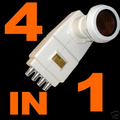

The best set up for FTA is a 31" dish, Motor, and proper lnb for DBS ( dn-bev ) and true FTA ( QPH-031 the best LNB ).....and your receiver
Their are 31 sat's out their with programing on them with over 2500 channels you can get with a clear sky and that set up......
Cost is around $150 and set up is very easy most times easer than all the switching required with using 2 dishes to just get a few DN or BEV sat's that MAY or MaY NOT have channels working at the time.
here is a sample page of the LNB please shop around as this may or may not be the best price. On ebay you can find motor-lnb combo's at great prices!
http://www.dvbhardware.com/product_info.php?cPath=7&products_id=55

ok so the QPH can get DN and FTA? I have the regular sized DN dish will that work?
Username: Ke5aqn
Post Number: 1839
you will need a 31" dish to get most of the fta birds
yes the QPH-031 not the QTH-031
The Link above that TESTER recommended has a sale on this Invacom QPH-031 ($45.95)
other sites sales for $60.00 and up.
