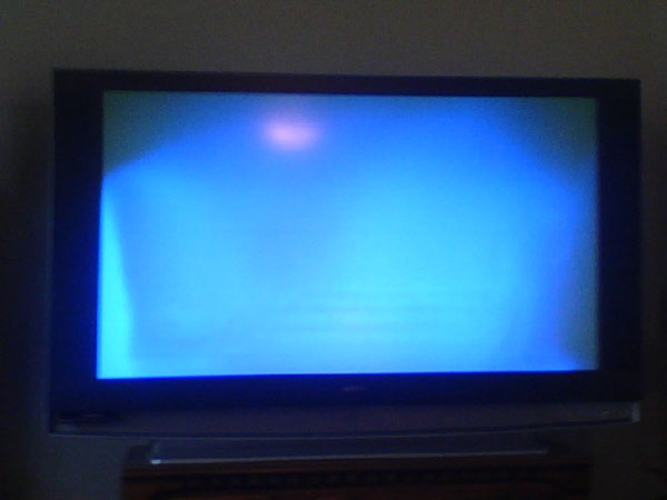

Username: Sonyboy
Registered: Aug-07
Thanks for the quick post Eric/Joey. Sorry, I wasn't specific enough to my problem earlier. I started seeing the pink stain around two months ago. I thought it was temporary problem, but just like everybody else, the pink stain has been part of my screen now whenever we watch TV. Sony folks pretty much told me that there's nothing else they could do but to recommend to replace the LCD, which would probably cost me a lot of $$.
I don't remember seeing a warranty card that says two years or so but the typical one year. Since you guys are more knowledgeable than me, then I would take your suggestion and send Sony a nice letter(Thanks Joey).
I've attached 2 pics, so please let me know if I really have a case on a possible optical block problem. I took it earlier this morning on a white screen background.
Thanks guys!

F Navarro,
Your pictures certainly don't reflect something that was the result of having your speakers too close to the TV, even IF they could affect rear projection TVs which I don't think they would, at least not like they affect tube TVs.
Your pictures could very well be the result of the blue or pink blob problem, but if so it's at a very advanced stage. it's hard to really tell from these pictures, it doesn't look quite like the typical blob pictures most people post, but that doesn't mean much. Please describe how the problem started and how it progressed, and over what period of time.
Most commonly, the problem starts with a slight discoloration at the very bottom of the TV, usually toward the corner, and slowly progresses along the bottom of the TV until it reaches the opposite end. From there it starts growing upward and outward, and may start to come from a new point of origin on the screen as well. Eventually, the entire picture will be covered although usually some areas are more deeply discolored than others. In my experience, it generally takes 6-8 weeks from first appearance before it's pretty much covering the entire screen.
I've attached pictures of most recent blue blob problem for comparison, this was at a very advanced stage after about 6 weeks, and taken against a gray background. All that remains of the original gray background is a very small spot in the upper left and right corners.
The process I described doesn't happen exactly the same for everyone and as I mentioned previously the color can sometimes be pink or even yellow. The discoloration might start at a different point on the TV and progress in a different direction, but the process itself is generally the same. I think the orientation of the LCD panels and their placement relative to the cooling element inside the optical block, may well have a lot to do with what color you see and where the discoloration starts and how it progresses. Since the optical block design varies from one model to the next, this accounts for the variation in how the problem manifests itself.
By the way, I looked up the warranty card for your TV and it does state 2 years for the "color picture tube", which is their screwed up terminology for the optical block or light engine. There is no color picture tube on a rear projection TV, and if you look at the more recent warranty cards in the last couple years for the same but slightly newer model rear projection TVs, the warranty cards specify 2 years on the optical block instead of the color picture tube. Clearly it was a typo on their part but it means the same thing.
The typo will create a little more hassle for you when you try to get the repairs covered, but all you have to do is show them the more recent warranty cards (available on Sony's website) which have the correct terminology on the same but newer model TV, and point out there there is no "color picture tube" in a rear projection. In any event, as long as it's the optical block, and it surely is based on your pictures, you're covered for 2 years from date of purchase no matter what the problem is (blue blob, roadmapping, etc.). However, I believe that after 1 year only the part is covered, and you still have to pay for the labor which should run around $300-$400 (the optical block alone runs around $900 usually).

Based on the pictures posted by F Navarro, I think it is far more likely that his problem arises from dust in the optical block (like the small purple fingerprints described by others). In theory, the optical block is OK...it just needs a cleaning. In contrast, the blue blob and star patterns indicate physical damage to the LCD parts. I think people have had varying degrees of success with using compressed air to clean out the dust. The process to get to the optical block is the same as when replacing it, so it is not a simple task:
http://splinke.googlepages.com/sonyrearprojectionlcdtv-opticalblock
The design of these optical blocks that are open to flying dust stirred up by the fans is a bit mind-boggling.

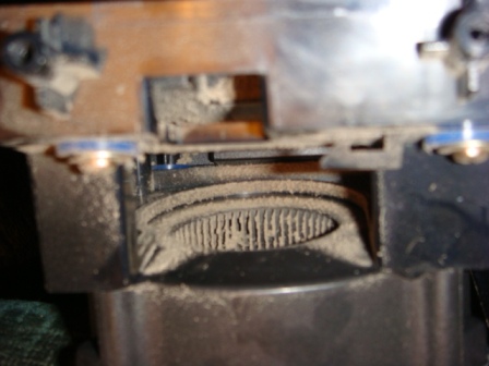

Username: Farmerpig
Post Number: 10
Registered: Jul-07
...My KDF-70XBR950 is now repaired..Thanks to Sony....The new optical block looks just like the old one, so the improvements they made are on the inside and not visible..I had dust, which burned up the LCD's...My tech who did the repairs said these TV's are really very good despite the optical block problems..He also said many other brands are having the same problems and are not being repaired by their companies...Sony is the only one to do out of warranty repairs or exchanges...My picture is now back to fabulous..I am happy Sony stepped up to the plate to correct this...At times they were a pain in the butt to deal with..I am feeling better about Sony, they did not let me down..I might buy something else from them now...Enjoy the pictures....

Username: Edenney
Post Number: 25
Frank C:
Congrats on getting your TV repaired, it's always so nice after having to deal with the blue blob for weeks or months. I haven't done any research about other manufacturer's TVs having similar problems, has anyone else out there heard anything about this or done any research about major problems with other manufacturer's rear projection TVs?
Thanks for the info about the apparently unchanged outward appearance of the optical block. I'm not overly surprised that any changes they made, if in fact they did make design changes as claimed, are not visible on the outside. The Optical Block has to fit into the exact same tight footprint which would severely limit any capacity for external changes. Best guess (and that's all it is) is that they changed the fan design, fan power, or altered the air flow in some manner to achieve a greater CFM and thus increase the cooling capacity. I think Sony would probably do their best to keep the change(s) under their hat, since by making the exact change known it would probably be obvious to most people that this was something that should have been caught and changed a long, long time ago.
That's a lot of dust on that part, is that the Optical Block or some other component? I presume it's the Optical block but it's impossible to tell with such a close up picture. I really wish I had asked the tech to let me take some detailed pictures of both my old and the new optical blocks when they recently repaired my TV, but unfortunately all I could think about at the time was having my TV fixed and like new again. If anybody out there is still waiting for their optical block to be replaced, it would be great if you could take several good pictures of both optical blocks when they effect the repairs. Try and get pictures from the same distance and angle of both parts so that a detailed comparison can be made.

Username: Slinke
Post Number: 17
The extremely dirty fan shown in Frank Connors' middle photo is the centrifugal fan that sits directly on top of the optical block. It is directly under the circular area of the gray part seen in the photo above it. This fan appears to suck air from the LCD panel area (on the right side of the top photo) and blow it down onto the lamp (lower-left of the top photo). That is a huge amount of dust, and it is not surprising that there was dust in the LCD area. You can see more detailed pictures (with a much cleaner centrifugal fan ) on my web site:

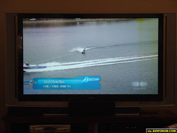

Username: A_gibler
Onawa, IA USA
Registered: Aug-07
Eric,
Our screen looks alot like that posted above by Navarro, except it has an approx dime sized white/light mark in the center with an upward directed beacon or strobe - kind of like a giant V. It doesn't matter whether there is or is not a device etc - same appearance - we can't change it from the solid screen appearance regardless of what we do (other than turn it off).
When we first turn it on, there are very distinct thin, horizontal multiple colored lines across the screen that fade within a minute or two and the screen starts off darker blue at the bottom then lightens a bit all over and forms the beacon type appearance in the center after another minute or so. Nothing we do changes this appearance at all.
Username: Edenney
Post Number: 30
Allison:
It definitely sounds like you have a variant of the "blob" problem, with the source being the Optical Block. If it's at all possible for you to post some pictures that would be great, but you're definitely going to need to get it examined by a Sony authorized tech. before anything else can happen.
Yours is the first KDF-E50A10 that I've seen mentioned in this forum that potentionally has the blob type of problem, so that's another reason I find it unusual. It may also be the first reported mid-2005 or newer rear projection Sony which potentially has the problem (at least that I've seen). There have been a few other owners of that model that have reported other misc. unrelated issues, but none with the blob defect.
I mention these things because it's going to be important for owners to know whether the same defect exists in the 2005 models, not just the 2004 and 2003 models. Since the Optical block usually takes about 2 years to fail with an average amount of usage, this is right about the time we'd start to see the failures if the 2005 models are defective as well.

I'll try to get some pictures and post them to this site. I noticed there are some prior posts from someone with a 42" version of our set in the archives through the end of July, but I don't remember exactly what the issue was - just that Sony offered to give credit towards another TV.

Eric D & Steve, Yes in fact the fan was replaced..It is part of the entire Optical Block that was replaced...A small electronic board attached outside of the optical block was also replaced...There was no dust on my LCD's (that I could see) it was burned and cracked due to the large amount of heat build up caused by dust in the fan..proper air movement was decreased due to the dust and no way to properly cool the heat from the lamp..
I hope this makes sense....This is my take anyway and what the tech found....I would have to say a better cooling system design & dust filter would be a way to solve this....I think........Also there is just no way of cleaning this...My tech said only replacement of the optical block is the cure....Like I said before, I am now repaired...The picture is Great, Just like new...But my warranty is only 30 days labor & 90 days Parts...Almost as much time as it took me to get it fixed....Sony really needs to work on that 7 year thing.......

That's helpful information, thanks Frank. My theory that they likely modified the fan or some aspect of the cooling in the new Optical Blocks to address the blob problem is still plausible then. Although it's still just an educated guess.

First, I must say that I am glad I found this forum. Lots of great people with lots of good info :-).
Second, I have a R60XBR1. This TV was made February of 2006 and "so far" I am totaly happy with it. Several weeks ago, I noticed a rather thick yellowish stripe on the right hand side of the screen going from top to bottom approximately 5 to 6 inches in from the side. At first I thought it was because we were watching "too" much non-HD programming in 4:3 ratio and it was possibly "conditioning" an image there. So we switched to wide mode and kept it there up till now. Problem is, the yellow or discolored stripe is still there. It fades somewhat with use but it stays there. Any ideas??

Please post one or more good pictures which clearly show the problem you're describing. This does not sound like a light engine issue, and it certainly isn't related to the "blob" problem that most of the people posting here have been unfortunate enough to experience. If you've been watching an excessive amount of non-HD programming and you're not stretching the image to fit the picture, either by selecting a Wide-Zoom mode on the TV or by selecting a mode on your cable or DirecTV that stretches the picture to fit, then it's possible you've burned in the line where the picture meets the gray background. If and when that happens, it's not going to go away. I can't say at all whether that's the case in your situation, but some pictues would be helpful. It would be unusual though that you'd only see this appear on one side and not the other since anytime the gray bar was present on the right, it would have been present on the left, and thus the burn-in should have happened equally.
Personally, I never watch anything without adjusting the picture to fill the screen, which avoids the burn-in problem and makes for a more enjoyable viewing experience for me. My TVs are perpetually in Wide Zoom and switch to Full mode automatically when viewing HD content. Depending on your cable box and which connection you're using, your TV may not allow you to switch to Wide-Zoom mode. In this case the only option is to view the picture with the bars showing, or stretch the picture using your cable box or DirecTV box. It's not as nice as Wide-Zoom mode is, but at least it fills the picture.

Username: Pilgrimg
Registered: Aug-07
Thanks for the response. Just a quick disclaimer, this picture is not of MY tv, I found this pic on another board and this pic is of my model tv and the EXACT same issue I am having with mine. The thread did say that they thought it may be a defective OB. ????? And thanks to the person who took this pic. Hope you dont mind. :-)
G Upload
Username: Edenney
Post Number: 36
I haven't seen that problem before myself. The positioning does look like it's right about where the border would be for non-HD content (you'd be able to tell better than anyone), however I'd expect to see a clear, sharp, demarcation line, not a relatively thick line from top to bottom. The wider spot at the top also doesn't jive with it being burn-in related from watching excessive non-HD content. As I mentioned before, if it were burn-in related, I'd expect to see the problem appear on both side at virtually the same time. Anyway, I don't believe it's light engine related and it's going to have to be repaired regardless.
Just schedule a service call ASAP and perhaps print out a good copy of this picture along with the explanation of what the problem was with that TV, so that it might give the tech a place to start if he or she has never seen this apparently rare problem before. Check and see if your service contract specifically states in-home repair so that they don't try to make you bring the TV in yourself, or so they don't take it in and keep it for weeks. Some contracts such as the one I have on my Sony KLV23M1 and my 32" Bravia, specifically state in-home repair. Those particular contracts were directly from Sony, not from a 3rd party.
When you get your TV repaired, please post what the problem was and what had to be repaired/replaced so that it might help others who experience the same problem.
Good luck!

I have completely struck out so far with Sony, to resolve blue blob issue with KF50WE610. Jose from exec committee called today, they will do NOTHING to resolve my problem... sigh. I am both mystified, and furious that Sony won't step up to fix this known problem.
Background: 50WE610 purchased July04, mfg May04. Blue blobs started about 30 days ago, and are getting worse. Called Sony Customer support - they were courteous, but offered no help; They required authorized service diagnosis to proceed further. Affordable Electronics in Austin spent 90 seconds diagnosing problem (fee was $134) repair estimate is $1950 - Optical Engine part alone is $1350. Called Customer support back, they offered nothing further; transferred me to Don in Customer Relations who only offered option of writing to executive committee.
Sent letter to EC, following guidance in other posts, on Friday (9/29). Jose called me today and said I was out of warranty, and there was nothing they would do. I argued that this is known problem, they have accommodated others with repair or replacement credit, I shouldn't have to pay $2000 to fix a $3000 HDTV after 3 years. But his only response is that he was sorry I was disappointed. I'm glad he was sorry... sigh.
So, now what, other than researching other-than-Sony replacement TVs? I want to write back to Sir Howard Stringer (CEO), with cc: to Exec Committee this time, about how disappointed I am that 1) this is a known and acknowledged (by Sony) problem; 2) they are arbitrary in their accommodation response; 3) Sony used to stand for QUALITY... do they really want to stiff their loyal customers like this?
Boy, am I not holding my breath....
I will consider filing suit in small claims court - Sony's arbitrary responses will, I think, support my claim.
I'm interested in experience from others with 50WE610 if you're willing to share -- did Sony agree to repair or replace your TV? Any other suggestions?

Thanks for all of the great information. So, I own a Sony KF-50WE610 and I started noticing the blue spot problem last night. Of course because my luck works this way, I noticed they extended the warranty until the end of September, 4 whole days ago! haha... So, am I just hosed? How much does this Optical Block repair cost? I am also one of those Sony customers that had the lamp replaced a few months after buying it. Has anyone heard of a class action lawsuit on these things?
Lastly, if repairing this thing comes in over $500 I will probably take a sledge hammer to it and call it an evening. Are there any TV's that would fit nicely on the Sony stand for this thing?

I have a Sony KDF 42A10 with problems that seem very familiar to the problems some of you have experienced--the bottom of my screen has blue fingers and it is getting worse. I bought the TV in Apr 06 and this started about a month ago. I am having difficulty getting Sony to work with me, I would appreciate suggestions from any and all. Thanks in advance, Jim

The warranty through the end of Sep. did not cover the blue blub problem on your model TV. The fact of the matter is that you're one of those people that are really getting hosed because Sony has chosen not to do anything about the infamous "blue blob" problem with owners of your model.
Now if you go back through the posts you'll find many, many posts with suggestions for people who have a model that isn't covered under the new extended warranty related to the blue blob problem. Others with your exact model have received a trade in value toward a new Sony TV (usually about $600 will get you into a nice new TV with a new warranty), however some others with your model have ran into a brick wall. There's no rhyme or reason, other than it depends on how you handle the situation and who handles it on the other end. As it happens, there's another owner with your same model who's been posting in the last couple days and he can share with you all of the helpful suggestions that myself and others have given him.
In short, all the answers you need to address the problem can be found by searching the recent posts and the archives from earlier this year. There are no guarantees, but I'd estimate your chances of getting the repair covered or mostly covered, or of getting a large credit towards a new TV at about 80%.

Jim H, your problem is somewhat unique and disturbing. The warranty extension for the "blue" issues only covers 2004 models (Grand WEGA III). However, it seems to be very common in the 2003 models, as well, and the lack of a warranty extension for these models is a source of much frustration for those owners, as clearly shown by this forum topic. Your KDFE42A10, however, appears to be a much newer (2006 Grand WEGA V) model. Does the design flaw carry through to all of their rear-projection LCD models--even the newer ones? Hopefully, this is not amongst the first of many new complaints as the newer models reach that 1.5-3.0 year time window.
See my Sony Optical Block Problems web page for more details.

Jim H, if you have a picture of your problem, please post it. Is it similar to the pictures posted for the older models?

Steve L., Yes, it is similiar to the pictures previously posted, I will post a picture later today. Jim
