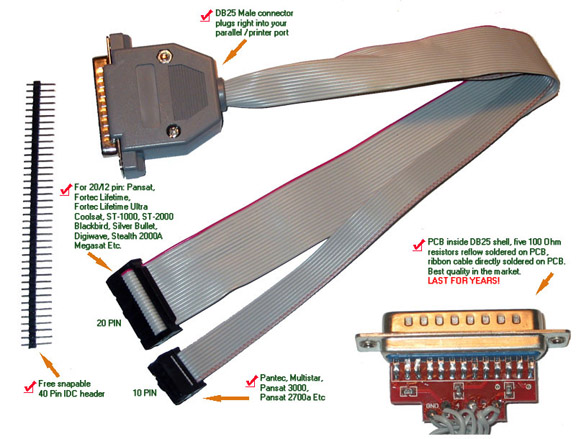

Gold Member Username: TapemanNew York City in-HD, NY Post Number: 1704 Registered: Oct-06 | J-taging is not very common to Viewsat Cuz to my knowledge it never happened I never did j-tag and I hope I never have to do it one day I may not be the best person for this task But this is what it may look like: PCB will contain bleed resistors Schematic: DB25 Via IDC20 IDC10 2 100 Ohm Resistor 9 4 (TMS) 3 100 Ohm Resistor 11 3 (TCK) 4 100 Ohm Resistor 13 1 (TDI) 5 100 Ohm Resistor 19 8 (TRST) 13 100 Ohm Resistor 15 6 (TDO) 18-25 100 Ohm Resistor 20 9 (GROUND) |
