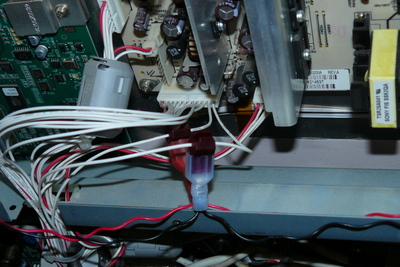

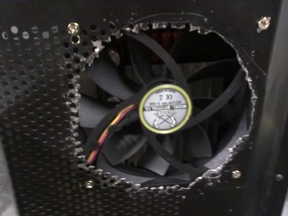

If anyone is interested in adding fans, I used
two - Scythe SY-1225SL12L Fan (mounting screws and connectors included)
http://www.svc.com/sy-1225sl12l.html
two - 120mm Grille
http://www.svc.com/fg002bk-22.html
The fans were positioned over the heatsinks with power for the new fans spliced into the existing fan wiring; only the power red and black wires were used, yellow rotation sense wire was not connected. The opening for the fans were cut with a jigsaw and hammered flat. According to the schematics, there are two regulators (KIA78R09F, each rated at 1 amp) in parallel to control the fans; the two additonal fan power requirements are well within the rating.
The newly added fans are extremely quiet--considering, they are only running at 9V.
Also, an easy way to determine if the Z Sustain board (aka X Sustain) is at fault is to let the TV warm up for several minutes and feel the two large heatsinks on the board, they should both be warm to hot; if either is cold to the touch, then the board is at fault.

Username: Cee9
Registered: Dec-09
I forgot to mention the fans do not turn on immediately but after a few minutes of power up.

Same issue as all the other Toshiba 50HP66s so I'll post my story and maybe it will help.
Determined that chip on z-sus board was shorted out. (determined by disconnecting the 'power connect cross-over cable' that connects the y-sus and z-sus together) and turning tv on... it then fully powered up.
With digital ohm-meter started testing for 'shorts' and found the heatsink for the 'top' chip (YPPD-J015B) was shorted to ground.
Purchased a replacement chip here... http://www.newegg.com/Product/Product.aspx?Item=N82E16835185057&Tpk=Scythe%20SY-1225SL12L
These things are REALLY silent but still move a good amount of air.
To power them, I 'spliced' into an already existing 12vfan wire coming off the middle power supply board. (look bottom-middle-left, watch your amps if you use different fans) To my delight the fans powered up perfectly. For placement i decided to have them blow 'air out' and centered them best I could over the top heatsink on each SUS board.
The results are amazing... without a fan the temps were easily 120-145 inside the TV. Now they only rise about 10-15 degrees above room temp.
The tv has been working great for over a month now, but time will tell. Special thanks to Cree9 for the idea!
Seems these things just run too hot!!
Time will tell, but moral of the story = ADD SOME EXTRA COOLING to keep those boards cool.

I'd like to add cooling fans to my Toshiba 50HP16 (same as 50HP66?), per thegeek's method above. The set has no fans now, and I can't locate a 12v connector to tap into. If anyone has a picture of the power supply board with the connector shown, or knows the connector number, I would greatly appreciate it. Thanks.
Username: Thegeeknme
Registered: Aug-10
Here's a highlighted screenshot from the service manual of where the connector with the +12fan and 12fan wires are... you should be able to see some reallly tiny "+12fan" and "-fan" lables above the far right two wires on that connector if I remember right....
http://dl.dropbox.com/u/10233897/Power%20Supply%20Pic.jpg
I'll try to get a 'real' picture to you in a few...
Here's the service manual for the 50hp66 as well...
http://dl.dropbox.com/u/10233897/50HP66_SVM.pdf
I just used a 18guage wire splice to tap into those + - feeds. Don' forget to watch your amps... the fans I spoke of above are only .2 each I think the max is 1amp?? i'll have to look..
Othewise the tv is still kick'n strong and the heat buildup is minimal. (actually seems to help heat the room ;-)

Then, I installed the 2 cooling fans as above (suggest using a nibbler to clean the cut hole, and use the grill. I set the fans to blow out at the top.
But, in the process of soldering the fan power wires to the two white wires at the right side of the 12 way as shown above, I accidentially shorted them when turning on the power (dumb). This created a cycling again, but now I could here a sissling on the power board and could see some sparks and black coating near a jumper. So, instead of buying a new power board, I desoldered the jumper and cleaned it up, and resoldered a new jumper wire. Checked that the solder joints were good with a magnifying glass and checked with an ohmmeter nerby solders to ensure no conductivity to them. After installing the power board, everything works great.
I hope that the fans will keep the 2 modules on the Y-SUS board cool and now my TV will not get the "pop of death".
