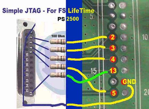

converted 2700 (clone), will only accept bin file moded by jvvh ... if after updated w wrong bin, ur receiver has 9rider dashs u need to do reconvertion it all over again with j27_205_1 (convertion & boot bin fin) then latest bin jvvh_215_pTd.
if ur receiver reboot to b-75 then u only need reload latest bin jvvh_215_pTd (start write bin at verifirst light appears on the display with blacklist updater 1.4).
u must use jtag only when turn on receiver rear sw with no display .. not thing happen at all.
jtag connection as below (picturured is a flu,2500 clone, real pansat 2500 has 20 pin header on pcb) and due to attachment file size restricted i can only email nessessary files and instruction to do jtag on pansat & FLU receivers. Upload

U very well may have a clone receiver, and uploaded a bin for the genuine receiver...this is VERY common for many people, thats why I recommend people use the CLONE safe bin (presently 217 v3 w tivo), even on their genuine receivers!...the "kill" usually does come later, within 1-3 days later, when using genuine 217 bin on a 2700 clone....
if absolutely NO power then U must jtag it...like pic above...if U have any power, then force upload an older clone bin , or the 2700 factory bin..

lk that was the bin i loaded i looked at the picture that ctran showed and my board is differant than that one any other pictures would be great pansat 2700a clone thank you so much.

Jtagging for Pansat 2700 - 3500
[link removed]
C&P:
this is the whole package deal for pansat model 2500, 2700, and 3500 with additional 29lv160cbtc-70 can be used with 2700 & 3500, all yours and no question address to me...i don't do jtag, period

this is the procedure i used and it work perfect.remember you need patience for this may have to try this step more than one time.good luck.
RTAP
Username: Rtap
MIAMI , FL MIAMI Post Number: 129
Registered: Jan-07
Posted on Tuesday, March 13, 2007 - 11:23 am:
may not work on some computers.you may need an older version computer or laptop.
1-- i purchased my jtag cable thru ebay
2-- remove cover of sat box only 3 screws.
3-- make sure your sat box is off and your computer is not running any programs.
4-- connect your jtag cable to computer and to reciever.
5-- now turn on sat box on rear switch
6-- open skymax 2.2 can be dowloaded basically any site make sure its a recommended site.
7-- change setting under adr flash to setting 2mb (7FE00000) and make sure select LPT port 1.
8-- under connection click start and wait till complete then under flash operation select erase and wait till complete.
9-- now under flash operation you will select write a window will pop up at the bottom change from rom file to all files. then select the pansat 3500s-flash 1(29LV160CBTC-70)-full.once you selected this file skymax will automatically start the process of writing the file to your sat box.depeding on your computer it may take a while.
10-- once it says complete turn off sat box remove jtag cable.
11-- once jtag cable is removed turn on switch and
the display screen should show b70,if so you have completed this procedure correctly.
12-- now you just have to load the boot file 80 and the current bin.
13-- enjoy.
