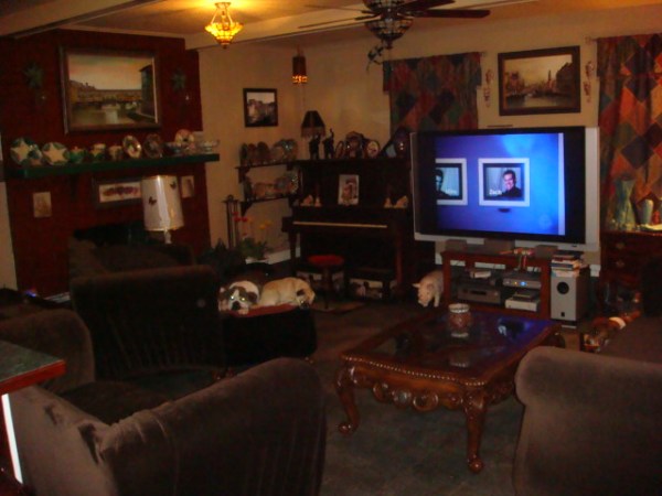

Matthew, I also have a KDF-70XBR950 with the Optical block problem (see photo in above posts)
Sony is repairing mine this week...Does the new optical block look like it has been changed or re-engineered...or will we get the blob back in 2 more years...
