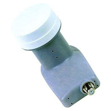

Gold Member Username: TapemanNew York City in-HD, NY Post Number: 1506 Registered: Oct-06 | Well This can be a highly complicated issue Based on what yo provided - Yo got a standatd LNB - Yo R at Bridgetown, Barbados which requires 4' dish My main question is what does your LNB look like? All DSS LNBs use 13V and 18V But I'm still guessing your LNB require an additional amplification voltage injected Headend Amp/LNB Power Supply This could be why yo are not getting a lock up signal. Or it could be your installation process is wrong I could be wrong since I'm guessing To confirm this DOES YOUR LNB LOOK LIKE THIS? - To find correct angle yo locate true north and start counting angle clockwise or use a compass - Is your dish aimed correctly? - Are yo moving your dish/elevation for final tweek? - Are yo selecting right satellite in antenna setup? - Are yo selecting right LNB type in antenna setup? If yo R doing all above correct then it has to be your LNB not compatible. It maybe was compatible with your previous dish I would say to avoid any trouble Just buy a known Circular LNB ($15 off e-bay) Stap it nicely in place of your LNB Yo can use your receiver as a satfinder by turning the beep option in your installation setup Yo'll be up and runing in few minutes |

New member Username: Bage881Bridgetown, St.Michael Barbados Post Number: 3 Registered: Sep-07 | nah my LNB looks something like thishttp://www.global-b2b-network.com/direct/dbimage/50344330/Single_Ku_band_Lnb.jpg![]() |
Gold Member Username: TapemanNew York City in-HD, NY Post Number: 1509 Registered: Oct-06 | Well If yo got channel lineup with signal and quality but no audio video Then your guy didn't program it right Yo said the guy programmed it Latest bin flash is 070914U.zip or 070911U.zip Yo need latest bin Yo need to use your Memory stick Yo need a Laptop or computer to plug memory stick to load BIN PGM Yo can get 070911U.zip or 070914U.zip From www-dsstester-com (no registration required FREE) www-DSSCentral-net (no registration required FREE) www-TotalFta-com (registration is required FREE) Don't forget to unzip it |
