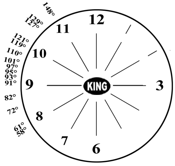

Gold Member Username: TapemanNew York City in-HD, NY Post Number: 1459 Registered: Oct-06 | If yo put a twin LNB you get both 82/91 One coaxial cable no DISEqC required Minor tweek elevation but skew is a must If yo want to run single 82 to 91 yo turn few degrees clockwise ![]() |

Bronze Member Username: Vhl71Post Number: 64 Registered: Jan-07 | thanks king.. so rotate it up a bit and then move it sideways?? |

Gold Member Username: TapemanNew York City in-HD, NY Post Number: 1463 Registered: Oct-06 | So I take this as Yo don't want both at same time No need for tools Many receivers got the beep option if yo can turn beep option on If want run single 91 yo turn pole slightly towards west (It is what I call clockwise). Elevation also slightly. Elevation: If yo are on east cost 82 to 91 yo move down If on West cost 82 to 91 yo move up But it is better to calculate it http://www.kusat.com/install/calculator2.php |

Bronze Member Username: Vhl71Post Number: 66 Registered: Jan-07 | i have an ariza thanx a lot guys..being first time (with dish pointing) after a bit of struggle, got 91 lined up..i had to swing a bit to west to get 91 (from my current 82 position).. |
