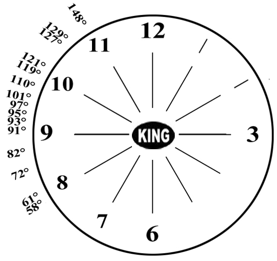

Also try and find a dish in the area that is pointing at bev and picture it on a clock in your head.

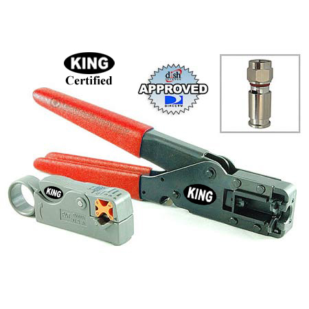

- Good shielded cables(RG-6) and sealed connectors

- I would print King's clock to know the relative Satellite fixed position and put it on
