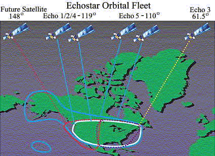

teddy. look at the satellites positions.Upload

I can not set 148 and 61.5 becouse my balcony cannot that wide. so any another way to I can see South Asian Channels
Thanks

you can get Jaya TV thru B*v, pick up nimiq 2 at 82. W
