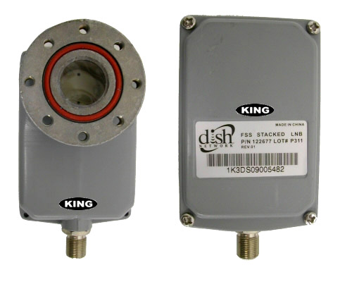

DN FSS LNBF looks like this:
Invacom Quad polarity has all four polarities with full frequency sweep that being broadcasted in US (11.7 - 12.7 GHz). They are a bit heavy in weight and larger in size
