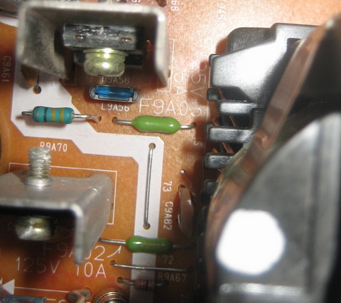

How to locate Mitsubishi Fuses
Username: Hevnsnt
I noticed a lot of posts asking how to find the fuses.. Wanted to take a picture of one so people could find them. In this pic, you can see the F9A03 fuse, it is the green "resistor" looking thing.
You can check the fuses by using a multimeter on the "Ohm" setting. When checking the fuse, an ohm of 0 indicates the fuse is good. An ohm of 0L or Infinity means the fuse is bad.
Hope this helps
