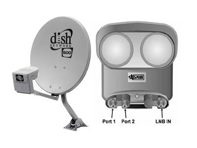

We installed a DP 500 Dual LNB with Pantsat 2700 recievers. We catch 110 signals but never been able to catch 119 signals. So my question is, is it possible that my dual LNB is defective or that it is not installed properly?
Maybe I am a lil new at this so I appologize for my ignorance but being that both LNB's are on one pod shouldnt both catch a signal if one is catching?
Echo 8.6 comes in at 85 % level and fluctuates anywhere from 80% to 90% on the quality. I believe this is 110 signal .

So I have 2 coaxial wires coming from position 1 & 3 on the LNB, going to ...

That is a Dish Pro Plus TWIN (DPP) LNB and receives 2 sat signals (110-119) with the capability of receiving a 3rd LNB and sat when 2nd dish is connected to the LNB IN port..

FYI...a DUAL LNB has ONLY 1 "eye" so can ONLY receiver 1 sat signal, BUT is called DUAL because it has 2 OUTPUTS for 2 receivers!...NOTICE how your pic of your LNB has 2 "eyes' (round white plastic covers), so it has 2 LNB's (for 2 sat signals)joined into 1 unit with 2 outputs (for 2 receivers), so its called a TWIN LNB, and since it also has an "LNB IN" connection and says Dish Pro PLUS logo on it its a DPP TWIN LNB..
Username: Lklives
Post Number: 8592
Also, in your pic, there is NO port #3...the Twin LNB's all have internal switches...
