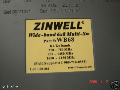

Bronze Member Username: Nr4pPost Number: 17 Registered: May-05 | With the Directv 5LNB system, they are down converting to 250Mhz. So that interferes with the UHF television signals when sharing a cable. There's a B-Band Converter supplied with some of these systems.. Directv normally wants it at the rear of the sat box. But if it is placed between the Diplexer and the Zinwell WB68 Multiswitch, (with the other Diplexer at the Sat box), it will work. |
Gold Member Username: TapemanNew York, NY Post Number: 1002 Registered: Oct-06 | It can't be 250MHz it is too low Video signal for satellite usually over 900 MHz It is called wideband multiswitch because it handles variety of bandwithd Both Ka/Ku ka is for for audio satellitte Ku is for Video satellite AT9 MPEG-4 Ku/Ka dish https://www.ecoustics.com/cgi-bin/bbs/show.pl?tpc=2&post=961931#POST961931 They do use 1650 to 2150 MHz As well as 950 to 1450 I honesty don't know what 250 to 750mhz for but I will have to guess for Audio They use multiple bands switchings for multiple sats due to vertical and horizntal polarity switching as well as 0/22Khz and 14/18 VDC DC componenent. For all those reasons it may not be a good idea to cascade with any other type of switch or diplexer. I don't blame you. But do you know something they may have a special diplexer that will work with this Zinwell. They can't take away the option of adding Antenna and diplexer is the only way to combine. Also there is a switch on receiver from back you may consider switching to either ch-3 or ch-4 this may hold the trick. for all people that can use diplexer the above diagram is how to. ![]() ![]() ![]() |
