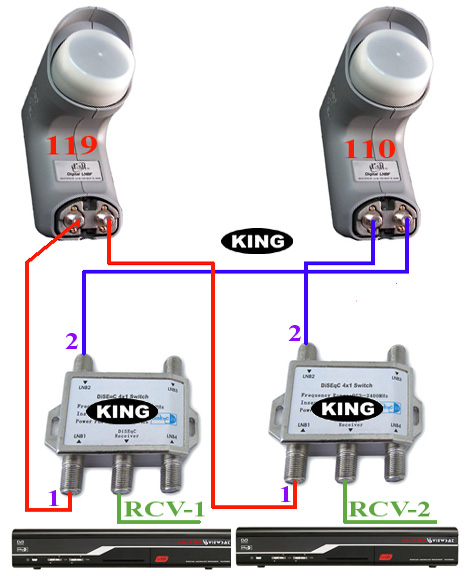

Jim what you are trying to do is similar to this:
Instead of (2)SW-21 use (2)DISEqC switches.
- Instead of 2 Dishes in your case 2 LNBs
- Each outlet from single LNB goes to 2 different switches
- use port-1 for 119, port-2 for 110
- Maintain same DISEqC/antenna setup to both receivers
- If you decide to add another Sat later just simply add on to input 3 and 4 on DISEqC
Ask more questions if need more help
Good luck with your installations

single LNB's have ONLY 1 output and receives 1 sat signal ONLY and CANNOT be used for 2 receivers...
dual LNB's have 2 outputs (for 2 receivers) and receive 1 satellite signal..
Twin LNB's have 2 outputs (for 2 receivers) and receive 2 sat signals...also has internal switch that combines these 2 sat signals into 1 cable from each output of this LNB..

Username: Lklives
Post Number: 8344
Looks good...its a simple thing...just wanted to clarify "single" versus "dual" and "twin" LNB's...those words get used erroneoulsly often and that can creat simple communication problem amongst peeps..
Nice diagram of 2 DUAL LNB's and 2 disque switches in use..now if the receiver antenna/dish settings are inputted exactly as the actual port switch #'s and correct LNB type and frequency , then all should be good when using 2 DUAL LNB's with 2 receivers..after a proper scan is performed..

king about the standard dual lnb connections, wouldnt be neccesary both cables out of the right outputs go to the same switch, and both from the left outputs on the lnbs go to the other switch???
Username: Tapeman
New York, NY
Post Number: 806
- Out of the LNB it doesn't matter either outlet
- into the DISEqC U must maintain input#
- Into antenna setup U also must maintain same assignment
But it will never hurt to keep all to prospective order. I would keep everything into a respective order.

somewhere on this board i read that left outputs on an lnb handle a certain voltage and right ones handle another something like 18 and 13, and if you combine them you interfere one stb with another.
just as info, not meaning to down your post.
thnx
Username: Lklives
Post Number: 8420
U are referring to Dish Pro TWIN LNB's..
Username: Tapeman
New York, NY
Post Number: 813
Vertical TPs are 13/14 Volts
Horizontal TPs are 17/18 Volts
What sets the voltage to control the polarity is supplied by the receiver. It controls the polarity switching on the LNB
