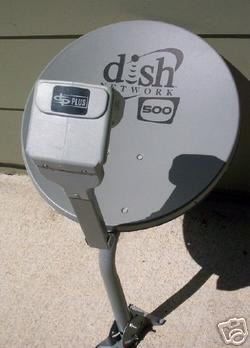

Guys,
I am living in the caribbean and we normally have to use the 1.8m Dish to get perfect signal but it will only pickup one satellite at a time. So, for instance, if I need 110, I will have to move the dish and if I need 119, I will have to move the dish again. So I was wondering if I can there is a way I can use some special arm to get both sat at the same time. I purchase the 1.8m arm but it didnt work. Maybe somebody has a mod that will.
Thank

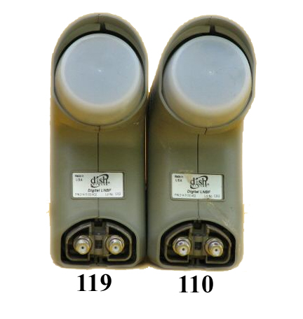

tony
- Don't move your dish
- Strap second LNB
- You'll need a 4-input DISEqC switch
- put 119 on port-1, 110 on port-2
- You'll need to assign each LNB to respective port in antenna setup

Username: Defender
King T,
Are you saying that I can just align another lnb and it will find the sat...How far apart do I have to set it up? Don't I have to use a arm with this dish?

There isn't other, only this, too far away ,doesn't works that way, try this .look at the photo.
image/bmpUpload
Username: Defender
Juan,
Is this on a 1.8m dish and what are the length apart from the original lnb and the length of the extension?
Username: Juancho
Superior Lake, Northwestern... Canada
Post Number: 721
the picture was posted in the hispanos only thread for someone who was trying many ways to catch other sat, after many days, he did it that way.that was tested, is no just information
Username: Defender
Thank,
Will take a look and see if I am lucky. One more thing where do I have to point the dish to 119 or 110? I am thinking either one, is that correct?
Username: Juancho
Post Number: 722
tony, that is a 2.4 m antennae
Username: Juancho
Post Number: 723
tony. use the adapted LNB for the 119, as the 110 has more Tps ,it Lnb has to be the primary.
Username: Defender
Kool, will try and let u know how it works
Username: Tapeman
Post Number: 657

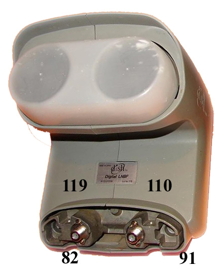

If you use this kind of LNB you'll need a 4-input DISEqC Switch
Username: Tapeman
Post Number: 658
If you use this kind of LNB you don't need a DISEqC switch
In fact one wire from either outlet to one or 2 receivers
This kind is friendly to all receivers
Username: Tapeman
Post Number: 659
Oops Correction before I get mugged
Username: Tapeman
Post Number: 660
If you use this Kind
It may or may not be compatible to few selective older receivers
Causing reception of only one Satellite due to wrong voltage requirements
