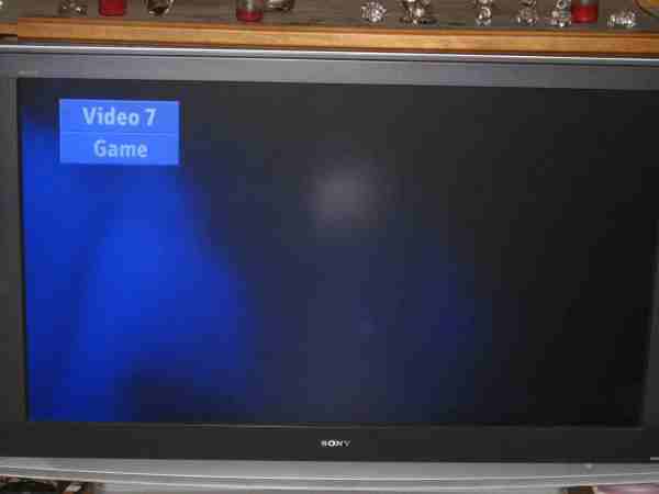

New member Username: BlueblobwegaPost Number: 2 Registered: Feb-07 | Tony, Are you saying you had the infamous "blue blob" problem and that a new lamp fixed this? Most all (99%) of the conversations I've read here and AVS Forums on this problem always results in the tech saying the optical block needs to be replaced. And at least for us US customers, Sony is being very stingy and telling most tough luck and offering very little if any help at all with the expense. Curious. Please let us know. My lamp has over 12,000 hrs. and this is what my display looks like. ![]() |

New member Username: BlueblobwegaPost Number: 4 Registered: Feb-07 | Yep. 42WE655 here too. And my power to picture times vary as well. No biggie but odd nonetheless. I think it has something to do with how cool the lamp is when powering up. In any event, keep your eye on your panel for the infamous blue blobs or roadmapping issue. These sets are notorious for this as there is a design flaw in the optical block. Word on the street is that it has something to do with dust accumulating in the fan screen that cools the optical block and it's a good idea to clean that periodically. Otherwise it will fry some components resulting in the problems above. Some Hitachi sets are having similar issues and guess what...the optical blocks are made by Sony. ![]() |
