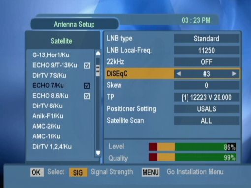

lose the CAPS!...take a breath...use PEROIDS!....I have NO clue what U said, but I belive U said DP Twins do not work with your Viewsat, which is 100% NOT true!..and YES there is an option for Dish pro in the menu!..check out other otions where says "Standard" here..
and disque 1 = 119...disque 2 = 110...

that is true...if U have 1 sat, U should get other sat....AND U are very close and maybe just a slight skew adjustment is needed....that dish has 2 LNBs for the 110 and 119, with 2 outputs for 2 receivers...each output carries BOTH the 110 and 119 to the receiver with NO external switch needed....
FIRSTt just add the 110 settings into receiver like U now have the 119..except 110 will be disque port #2, 119=#1, similiar to pic ABOVE,,,THEN SCAN THE 110 SAT..MAYBE DISH IS ALREADY ALIGNED FOR BOTH...
IF NO PIC THEN, JUST ADJUST THE DISH CORRECTLY..and then scan again

you see guys that's the confusing part i was talking baout . one fat dishpro head u can get 119 and 110. now u have only one cable coming from the lnb that carry 2 signals. if u have to use an otther dish combined we have to use a diseqc switch right. now let assume 61.5 goes to port 3 if u have only one cable coming from the fat head ,what number u can assign to 119 and 110 it has to be the same number. if in port 1 then 119 port 1 and 110 port . . becuz how could u put 2 different numbers if the cable itself goes to one number? i hope u got my point . thanxxxxxxxxx. it easy with the fat head that dont have dishpro logo you can assign the type of lnb which is legacy twin lnb1 #119 and legacy twin lnb2 #110 and if u got switch out u assign the same number of the dseqc .
this is my set up that dont work with dishpro fat head :
echo7
lnb type : ocp-dp
22kh :off
diseqc: 1
ect
echo 8:
lnb type : ocd-dp
22kh off
diseqc : 1 also simply the same cable goes to the same port.
echo 3
whatever port assigned to .
correct me if im wrong . thanx
