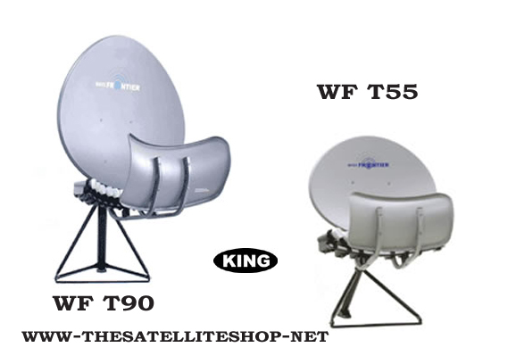

Wave Frontier Toroidal T90 Dish w LNBFs
Main Reflector: 38"x 43"
Sub Reflector: 14"x33"
Weight: 31 Lb
Polarization: Circular and Linear
Operating Frequency: 10.70 - 12.75 GHz
Multi Sat Range: 40 degrees in arc
Band Gain @ 12.5 G Hz: 39dbW -- 40 dbW
Price: $230.00 USD
Wave Frontier T55 Multi LNB Dish w LNBFs
Main Reflector: 34"x 38"
Sub Reflector: 13"x33"
Weight: 28 Lb
Price: $190.00 USD
Both available on www-thesatelliteshop-net
