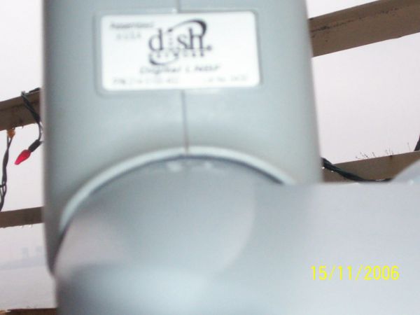

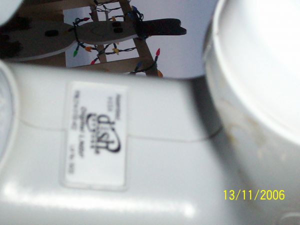

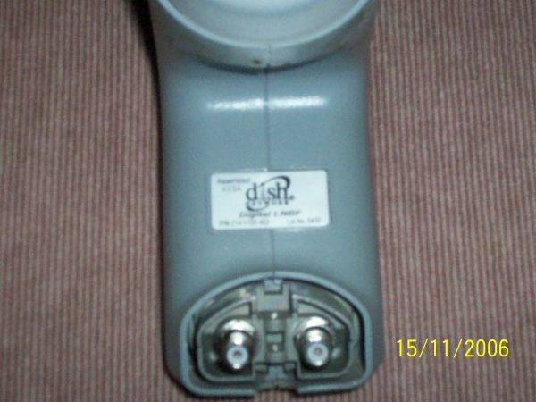

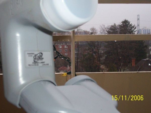

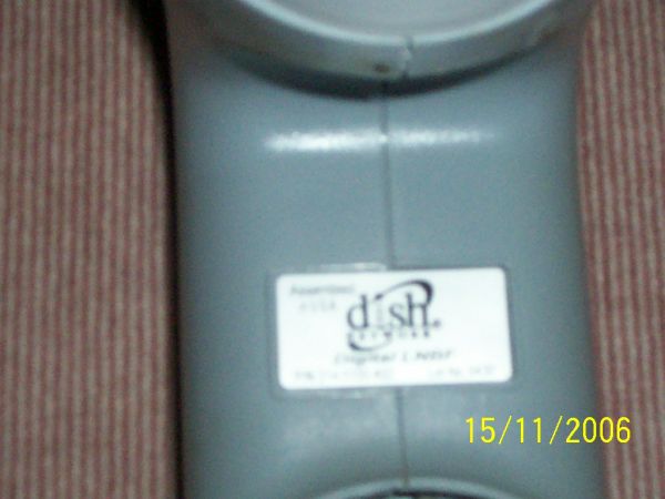

Bronze Member Username: VividPost Number: 18 Registered: May-06 | Hello There Thanks again for the words and info. My receiver that I am using at this moment for FTA is a Panset 2500A-N2. Perhaps I never mentioned that. As far as the LNB's go? Sorry guys, but they say right on them, Dish Network. Same company owns Dish Network & Bell ExpressVu. As it is, untill (2) years ago, majority of the Bell ExpressVu receivers even said Dish Network on them. Right on the LNB's, they say Dish Network. No reason to lie, and can't make a mistake. That is the way the Bell ExpressVu systems are. I am trying to upload the photo's I took to show you. I tried to send (3) last night, but it said they were to big. I don't know how to make a photo smaller, so perhaps if I send one at a time? If it doesn't work, I would be happy to E-Mail both of you the photo's from my E-Mail account to yours. Just say the word. Lastly, I know better knowledge of a receiver would help, but quite honestly, besides just wanting to figure out why all the channels on 82 don't show-up on FTA, isn't a real concern to me. I have Bell Legal (2) recievers, DirecTv. Sub (through a contact), Dish Network FTA (everything open), Bell FTA 91 (everything open), and I am just fooling and trying to get Bell FTA 82 (everything open). That was all I am trying to do here. If it doesn't open everything up, then no big deal. I tried. I am still going to see my dealer this weekend. Thanks again for everything, and if the photo's don't work, let me E-Mail them to you. Sincerely, Vivid |
Bronze Member Username: VividPost Number: 19 Registered: May-06 | Hello There Trying the 2nd Photo Vivid |
Bronze Member Username: VividPost Number: 20 Registered: May-06 | Hello There I can't upload the photo's. Well, actually, I can upload them, but this board is saying they're too large. I tried to make them smaller, but I don't think it worked. So, anyways, I have (5-6) photo's showing the Bell ExpressVu system, for which the LNB's state and say Dish Network. If you guys want to see them, send me your E-Mail address and I will gladly send them off. Mine is thegame2366@hotmail.com and I will be more than happy to send them. Vivid |
Gold Member Username: LklivesPost Number: 5534 Registered: Jan-06 | Are U using the 284T bin?..and Pansat clones are the easiest of all receivers to use..and DN usualy use DP twins LNBs or DN legacy twins for sats 9 degrees apart...since U say your LNB's say Dishnet, then I'm presuming U are using DN legacy twins, which do NOT work well with pansats or clones..they have interior switches that conflict with most FTA receivers.....but honestly I think U also may have a dish alignment problem, even from the installer...cause its VERY odd that your Bev sub AND panset receive the exact same channels...maybe the alighnment is bad and U are also missing channels from your Bev sub too.. |
Bronze Member Username: VividPost Number: 21 Registered: May-06 | Hello There Yes, I am using the 284T Bin. THat's interesting to here about how my Bell LNB's may not work well with Pansats or Clones. That's interesting because, I have always used an old DirecTv. dish for my FTA. However, this time, I thought I would just run one of my Legal Bell Systems to the FTA, and see what happens. And you know what has happened? As far as it not being aligned? I am certain it's perfect. Obviously, anything is possible, but I felt it was perfect. My Bell Signal is 100%, and Everything I pay for, is there. Then, when I take a Bell Sub, and feed it to FTA, I am missing as you know, a few on 91, and almost everything on 82? Interesting? As for the Bell Sub and Pansat receiving the same? Well, yes and no. See, I don't subscribe to Bell 82. However, when I myself switch my Bell sub to 82, there are at least (30) channels that work. Now, the Bell FTA on 82, receives some of those (30) channels, but then what appears to be everything International. Now the last reason I believe the alignment is okay is, my Bell Sub, receives everything I pay for on 91, and what I mentioned on 82. Still perfect 100% signal strength. It's just the panset that doesn't receive anything for Bell, 82, FTA, on the Horizontel feed? Do you think I should try, and hook this panset already loaded for Bell, up to one of my old Amercian Dishes I have, and see if it receives H & V? I would be willing to try tomorrow, if you thought it may make a change? Let me know some thoughts only if you have the time. Thanks again for the info and advice. Vivid |
Gold Member Username: LklivesPost Number: 5542 Registered: Jan-06 | its NOT the dish..its the LNB's on the Dish!...and u double talked again about your Bev 82 sub.. See, I don't subscribe to Bell 82. However, when I myself switch my Bell sub to 82 I have never subbed to Bev obviously...but I thought that the Bev sub would give U not just 1 satellite, but BOTH satellites with some channels coming from BOTH..thats why I also believe U have a Installed Dishnet Legacy TWIN LNB (made specifically for either the 82-91 or the 110-119 sats and DISHNET OR BEV receivers, NOT FTA) with built in SW switches that are causing problems with your Pansat FTA.. |
Silver Member Username: MorispastoraPopoth, Guanajuato Tepito Post Number: 764 Registered: Aug-06 | The bell's LNB's logo said DISH tm. made in japan, no dish network.... |
Gold Member Username: LklivesPost Number: 5545 Registered: Jan-06 | ooohh...thats a different story..hell I don't know what the problem is then...LOL...not familiar with Bev hardware, other than its LNB's are circular and most can be used with FTA..same as dishNETWORK LNB's..MOST, NOT ALL can be used! |
