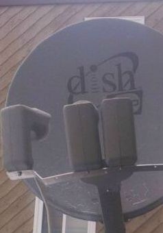

I dont think you are understanding me, I have a lnb bracket for DISH 500 that allows you to receive 91,101,110,119,& 129 all off of the DISH 500. I am only trying to get help with why I have S st 67% and no Q. I dont think that anything was funny about that question. I have no problem with getting new dish ,in fact I have about 5 of them sitting in my basement all different sizes, but this bracket allows you to take it all from dish 500.

1- If you point this dish to 110 you can get (91,110,119) this is the most you can get with one single 24" dish
2- You can't get 119 and 148 with this dish even if you have good signal on 148. It will show signal but it will scan 119 (Trust me)
3- If you have at least 33" dish then you can get 4 or 5 SATs.
Also 2 dish is no problem you can get up to 6 SATs
This is like if you are trying to milk a Bull. (you can't do it)

LK, I just wanted to thank you for helping me out. I took your suggestion and went through the initial installation and I got the signal the right way. I now have 91, 110, & 119 on my dish 500. Thankyou again. The bull has been milked.
