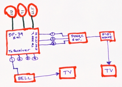

Hi Guys , I need some help with an issue as I have not been able to solve. It has to do with loss of dish signals when I use a splitter to split the signal from the Sattallite dish (coming through a DiSeqC switch) to feed it to two receivers digiwave 7000 and Bell 3100 that i have. I use the splitter after the switch.
I have 3 dishes: 1. BEV 91, 2. Echo 110, 3. Echo 61.5. The 3 dishes feed into DIGIWAVE 4x DiSEqC switch and I have bell dish on port A, echo61.5 on port b and echo110 on port c. From the switch the cable goes into digiwave receiver where I can select echo 110 and echo 61.5. Earlier, I was just manually shifting the cable between bell receiver and digiwave. But to avoid this hassel ,I purchased a splitter (2.3Ghz) with 4 power pass ports so I can give input to two receivers without having to shift the cable. But the moment I connet the splitter and the two receivers, the bell receiver looses signal. The bell receiver also looses the signal when I change the channels on the digiwave receiver. Some how they seem to be connected even though I thought by using a splitter the splited signal should be independent . Is there a way to split the signal after the DiSEqC switch to feed it to two receiver so they can work independently? Am i using the wrong kind of splitter? Of so, please let me know of the proper specifications and where can i find it.
Earlier the bell receiver was giving trouble when I tried using bell dish on other ports of theDiSEqC switch; it only seems to work if i give bell dish the Port A. . If someone has insight on this i will deeply appreciate it. Thanks.

Username: Totaldikguy
Post Number: 191
Sahr, It has been mentioned in this forum countlessly, that you can not use splitters for DSS signal. It is a digital signal. You are not dealing with analog comcast cable..
You better remove that splitter, before it fries your hardwares.

Username: Sahr
Post Number: 11
TDG, Thanks for clarifying some of the issues. I have removed the splitter, but then what should I use in it's place to give output to two receivers without loosing signals for one or the other?
And some body mentioned that I hijacked panachalover's thread, I did not hijack anything. I just posted an issue for help. I thought that was the purpose of the foroum and beside this thread seems revelant cuz people were already dicussing various combinations of LNBs and receivers.
Anyway, now can someone please advise me as to what to use in place of the splitter that I was using to give feed to two receivers? Thanks.
Post Number: 193
USE DISH PRO LNB ONLYUpload
Post Number: 194
Sahr, digiwave will have unstable signal if you connect it to Port #2 (next to Bell), if Bell is turned OFF. BUT will be running OK (Digiwave) if you follow the diagram.
Bell itself will be OK all the time, because it has sufficient current (amperage) output to supply the DP-34.
#1,2,3, where the Diseqc is connected is just a loop thru output, so digiwave will be OK all the time.
Username: Sahr
Post Number: 12
TDG, Thanks for all the help and the nice diagram. I guess, I have to buy a DP-34 switch. It seems that I will still have to run two separate wires to the two receivers. Is there no way that I can have one wire going into the room where the TV is and do some kind of spiliting at the end of that wire to give feed to two receivers. This is cuz I just have one tv, but two receivers. Thanks.
