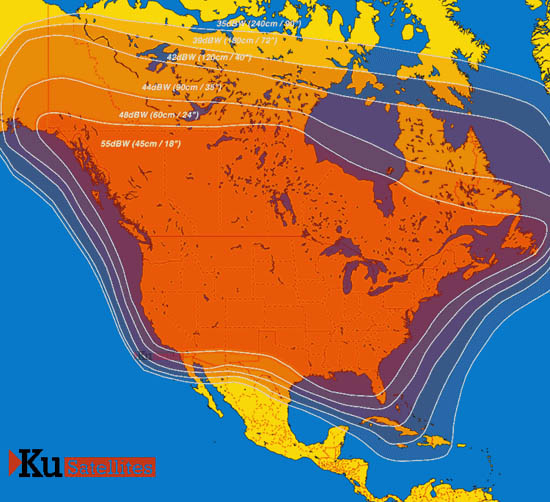

Silver Member Username: WoofyOntario Canada Post Number: 185 Registered: Feb-06 | Should be no problem with that size dish .![]() |

New member Username: Erenia0324Post Number: 4 Registered: Nov-05 | hi all. listen i'm getting pretty much everything from bev. except the venus and very few other. i check that 12253tp and it at zero. i guess the 39.5 inch dish not big enought for south florida. |

Silver Member Username: WoofyOntario Canada Post Number: 188 Registered: Feb-06 | Di you look at the map.. a 24" dish is plenty for all Florida. Lat/Long STAR CHOICE BELL EXPRESSVU N W El/Az E-2 F-1 El/Az NIMIQ Cm Cm Cm ____________________________________________________________________ FLORIDA Daytona Beach 29.2 81.0 45.4 225.3 --- 110 54.2 199.8 60 Fort Myers 26.6 81.9 48.0 226.7 --- 110 57.3 199.7 60 Fort Pierce 27.5 80.3 46.3 227.9 --- 110 55.8 202.2 60 Gainesville 29.7 82.3 45.9 223.3 --- 100 54.1 197.2 60 Jacksonville 30.3 81.7 44.9 223.6 --- 100 53.2 198.1 60 Key West 24.5 81.8 49.5 229.0 --- 120 59.5 201.3 60 Miami 25.8 80.2 47.4 229.6 --- 120 57.5 203.7 60 Orlando 28.5 81.4 46.2 225.5 --- 110 55.0 199.5 60 Panama City 30.2 85.7 47.6 218.3 --- 100 54.4 190.6 60 Pensacola 30.4 87.2 48.3 215.8 --- 100 54.3 187.4 60 Tallahassee 30.4 84.3 46.5 220.0 --- 100 53.8 193.1 60 Tampa 27.9 82.5 47.5 224.7 --- 110 56.1 197.8 60 |

Silver Member Username: WoofyOntario Canada Post Number: 191 Registered: Feb-06 | This if from another site..you have a big enough dish..but it does explain what LK was trying to tell you. Re: Venus/transponder 12253 If your signal quality is low (red) for that tp then you will not get those channels. If you are in S.Fla or S.Calif you may need a larger dish. You may only need to peak your dish. While watching that tp, hold the dish by the edges and flex it up/down/l and r. See if the quality changes. Adjust dish accordingly if needed. |
