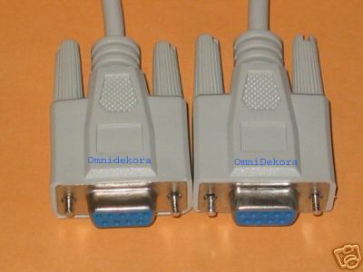

New member Username: New2thegameUsa, North Usa Post Number: 7 Registered: May-06 | Can I use this cable to upload the bin through my computers com port. 6 Feet RS-232 Straight Cable 9Pin Female to Female ![]() |
Gold Member Username: LklivesPost Number: 3506 Registered: Jan-06 | That cable should work with CORRECT SERIAL port, not USB port! |
New member Username: New2thegameUsa, North Usa Post Number: 9 Registered: May-06 | I do have one in back of my computer. Thanks again. |
Gold Member Username: LklivesPost Number: 3509 Registered: Jan-06 | Must tell uploader software the correct comport.. |
