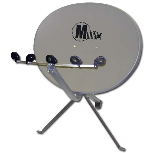

Silver Member Username: BoycePost Number: 265 Registered: Apr-06 | If you faceing to the front dish, it should like Back of Dish <-----------------------------------> 82 91 101 105 110 119/121 Front of dish |
Silver Member Username: BoycePost Number: 266 Registered: Apr-06 | Do you want get 101 from DTV or what else? Why you need Linear LNB? BTW if you can to catch 2 bird on a dish, you need skew the dish. |
Bronze Member Username: Outlooker202Post Number: 25 Registered: Jun-06 | a skew is not necessary as he said .... LNB(119) in left side of 110 to get 119, notice that the LNB(119) higher than LNB(110)about 2 inches he already has the skew ...just not the correct skew for 101 Linear LNB is required to get AMC 4 which is 101 in orbit, it shares space w/ DirecTv R/4S/8 sat, I assume he going aftert viet channel (VPTV, CGN) if so than a linear LNB is required So get your FACT straight. what channels are u trying to get. Which bring back to the question, if may be possible to get 101 using 18"/20" but it has to be the center LNB as circular dish focus the majority signal to the "center arm" |
Silver Member Username: BoycePost Number: 268 Registered: Apr-06 | I don't know about AMC4, I didn't try get it, but I did get 119 110 101(DTV) 91 use a old DTV (channel master 24 X 18)oval dish. and for the skew, if you get two, you will get all. |

Silver Member Username: BoycePost Number: 276 Registered: Apr-06 | Base on where you are(location). I have to skew (turn my dish 91 side up high, and 119 side low) clockwise. |
Bronze Member Username: Outlooker202Post Number: 27 Registered: Jun-06 | Boyce is correct, the skew depends on your location. Here is a Sat caluator, which will help you determine your skew, I would center 101 first as linear are much weaker and work from there. Using Boyce picture is a perfert example of who skew would for example ----------------- perfert level ---- sss--- sssssss--- (ingore the ss (place holder) Boyce is correct about the skew sat depend on your location of coure --> if lots like a ladder which is Now image the ----- line rotate say 45 degree , that is the screw When you mention .... if compare to my LNB(119) it is higher than LBB(110). And you mention about skew . Could you give me some words how to adjust a skew up/down right/left ... 119 sss110 ssssss101 sssssssss sssssssssss THAT the wy it should look like when ur finished, B4 this complicated, does your dish have a skew plate it should be on the back side of the dish at the top of the pole (where the dish attaches to the pole mount) if so your pretty much set. if not u will have to move ur lnb up and down according. If your not sure what the heck i trying to describe, go out into your neigbhoord and look at neigbors' dish will like look tiled (especailly superdish) and DirectTV oval dish ... that is the skew in action where all lnb are leveled. (same height) [link removed] |
Silver Member Username: BoycePost Number: 285 Registered: Apr-06 | or you can try this http://www.kusat.com/go.php?path=/install/look.php |

Silver Member Username: BoycePost Number: 291 Registered: Apr-06 | If your dish is big enough, you can use the quad QPH-031 to get 119 and 121 at the same time/spot. OR change 119 to Linear LNB, hairy move to north, you shold get it. 121 you need Linear LNB. BTW which bird you want to get now, look like you want try every one, if you really want to try each, you better install a T-90 dish, or cheaper way use a multi-star 30" X 39" Oval dish like I did, after one time setup, you can easy to add /remove LNB |
Silver Member Username: BoycePost Number: 292 Registered: Apr-06 | Like this ![]() |
Bronze Member Username: Outlooker202Post Number: 35 Registered: Jun-06 | Bui, your not listening. Lock on to 101.. then add 119, 110 to your dish Uh you mention, if you have a round dish, you MUST MUST MUST have the linear on the center arm. it doable, but if you have a tough time trying to get 1 linear, then 2+ linear on your dish is out of the question for u. The Best dish for a multiple LNB setup would be an ellipitical 36". Here a picture of his setup. (this is from S. Cali where 121 is "easier to find") ![]() |
