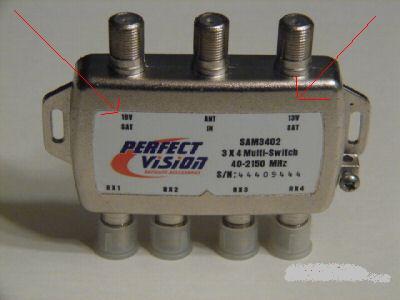

Also at the multiswitch there a 2 ports: 13V and 18V. What port should I use? When I plug from Diseq to 13V port the multiswitch seems to be warm, more than a normal warm. I use the 18V port now. When should I use the 13V or the 18V ports? Thanks.

so what is the diff. b/w 13V and 18V ports? I am not sure the switch got warm when I used 13V port because it was incorrect (should use 18V port instead) or the switch is defective. Thx.

Anna, not to break in but what voltage are you supplying. I'd guess 18v and if you put 18v into 13v port things are going to heat up. Get a cheap volt meter.

The ports are for Satellite-in cable fed from the Diseqc switch so I never think of using a meter to measure the voltage.
The red arrows are where it says 13V and 18V so I thought there was something else not explaned well. Thanks.

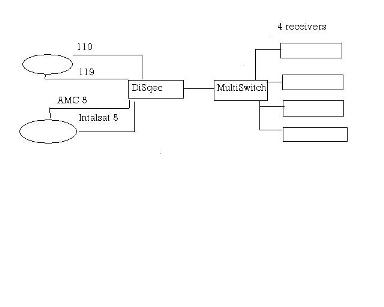

I used this switch to split. I have another receiver, 2 total. Does this switch do the job( 1 in from the Diseqc, 2 out to 2 receivers ) or I must buy a splitter instead? Thanks.

U can use that switch ONLY...do NOT need disque switch..or use 2 inexpensive disque switches would suffice..and work better...

You said I use the multi switch only or 2 Diseqc switches but neither one seem to work for me. I have 4 sat: 110, 119, Intelsat 5, and AMC 5. I have 2 receivers, may be 4 later. If I use the multiswitch ONLY, I can't have 4 inputs. If I use 1 DiSqec, I can't have more than 1 receiver. Using 2 DiSeqc switches like you said, I can make it works to hook up 4 receivers. What is the setup will work best for me? I thoguht this is the only choice. Thx.

My mistake....sorry!....I was thinking U had a 4x4 multiswitch, not 2x4 switch...U must use either a 4x4 multiswitch or 2 disque switches..
http://sadoun.com/Sat/Order/Switches/DirecTV-switches.htm
BTW..When viewing Horizontal Transponders, the receiver will put out 13volts, versus when viewing Vertical, it will put out 18volts, which allows the LNB to distinguish between which TPs it should get..
