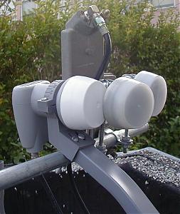

Gold Member Username: LklivesPost Number: 1988 Registered: Jan-06 | C band info is best at al7bar.t*k....buy a used superdish from a DSS forums with buy/sell area, made just for that..or buy a cheap 30 inch dish and make your own poormans superdish..I have pics here on other threads..this has 4 lnb's 91-110-119-121...notice how the 119 blocks part of the 121 LNB, cause they are so close.. ![]() |
Bronze Member Username: PaintPost Number: 34 Registered: Mar-06 | Thanks LK, you should publish book, for educational purpose only!! |

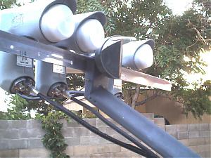

New member Username: NamnguyenkyMississauga, Ontario Canada Post Number: 1 Registered: Apr-06 | I USE 39' EAGLE STAR WITH BRACKET AND GET 82,91,T5,AMC4,110,119 TRYING TO GET 121 BUT NO LUCK CAN ANYONE GIVE ME AN IDEA (FROM TORONTO CANADA) THANKS ![]() |
Gold Member Username: LklivesPost Number: 1998 Registered: Jan-06 | That photo does have the 121.. |
