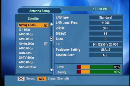

Silver Member Username: LeewKetchikan, ALASKA Post Number: 405 Registered: Jan-06 | @ bill courtois ,All Venus channels you can get only from Nimiq 1.3.... |
Silver Member Username: LeewKetchikan, ALASKA Post Number: 406 Registered: Jan-06 | ![]() |
Gold Member Username: LklivesPost Number: 1978 Registered: Jan-06 | Bill the dish is not aligned correctly....U are WAY off...U are aimed at 91W...U want 110 and 119 W....U are off 20-30 degrees!...go way more East (maybe 3-4 inches) and elevated..depending where U live...why don't U just use the simple satellite finder files that dsscommunity has! |
