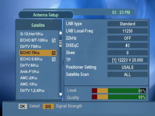

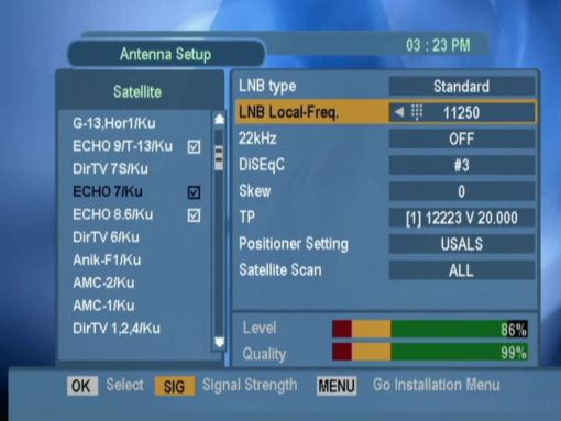

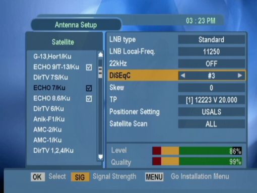

| Silver MemberUsername: Leew Ketchikan, ALASKA Post Number: 246 Registered: Jan-06 | Just pay aten...on YELLO MARKS, Check out all my settings ,if you have motor just live OFF,my is stay on USALS         | |
| Silver MemberUsername: Leew Ketchikan, ALASKA Post Number: 247 Registered: Jan-06 | and more     | |

| Silver MemberUsername: Leew Ketchikan, ALASKA Post Number: 257 Registered: Jan-06 | ok,first of all you have to scan all yours dishes to make sure all hardware is working 100% and you can get some  channels ,I mean all of them ,wide open (decoded),then you ,let say cut this freaki* line by  insert switch ,Two cables IN, one out.Then you go to fta menu (antenna setup )and make correction on Diseq # .That is all.  | |
