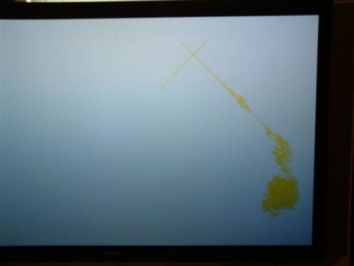

Add one more victim to this group. Bought my 60" KF60WE610 on 11/22/03 and it just started with the grid pattern on 10/10/05. I bought the extended warranty through Circuit City for $599.00. I dreaded buying it because it was the most expensive warranty from any of the retailers at the time. Thought about cancelling several times because everyone says extended warranty's are a scam. For once it's paying off. Called Circuit City warranty department and a local repair joint scheduled an appointment for two weeks from now. Not to happy about the two week delay but I'm sure they put the paying customers first.
Username: Villanman
And another
Sony KDF60XBR950.. almost 2 years old. :-(

Add me to the List as well. KF-50WE610 approx. 1.9 months old. etch-a-scketch crap showed up the other day. I've read others here who claim they've resolved the issue by leaving the TV on for a day or two. The "Roadmap" is said to slowly disapear over that duration. I'll give it a try but am not a happy camper about this.I paid a premium for this set and thought I was buying a quality product, not a name. Anyone here have a phone number & name of a sony contact I can negotiate with? Thanks. Would be interested in class action if that is organized.
Username: Villanman
Mine didn't come close to going away even after a week. It may change form and a few stray lines might disappear, but the main spot never budged, if anything it got worse. The only solution I know of is to replace the optical block/light engine. Mine is still in the shop waiting for that part to come in.
Username: Villanman
This is how it changed after a week. Top pic is when it first reared it's ugly head, Second pic is a week later before it went to the shop. Upload

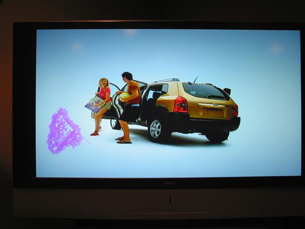

-Same problem KF50WE610 - 50" Grand WEGA, nearly 2 years old
-Daughter noticed "purple lines" several weeks ago on left lower corner when watching full screen picture(this area is hidden when watching normal TV which shows picture in centre and black bands on R and L side.
-it is green color on black background, bright purple on white background
-apparently was larger in size at beginning several weeks ago and is now smaller - about 4x4inches
-called sony(canada)they said local tech has to look at problem and give report. They implied that they dont know much
-told them numerous cases mentioned on internet and photos are the same and this is said to be a "optical block" problem. Also told them sony has provided the part free to some people or allowed some to exchange TV's for a fee.
-they said that a tech HAD to look at it BUT they also said that it was expensive to fix and the techs report and my original bill has to be sent to their "support team" which would make a decision within 10 days.

I have a 60 inch sony LCD and I ended up with a magenta street map after 7 months. I also have a 55 inch LCD and I am now worried that I have two losers from SONY! If you are thinking or buying DON'T!!!!!!
Unregistered guest
I just got the pixel problem that looks like a street map as pictured at the beginning of this forum. I've been around and around with Sony about this. What they need to do is replace the part free of charge. They said they would pay for half the cost of the part leaving me the other half and all of the Labor charges(roughly $800.00). The only fix is to replace the entire optical assembly (Part#A1605853A) this part being for the KF-50WE610 mind you. This failed at approximately 23 months. I believe we have a possible class action suit on this. My next step is to notify the local news agencies.

My KDF-50WE655 came down with the same yellow spider-web problem a couple of days ago. It is a big blotch in the lower, right-hand side of the screen. Luckly, I have owned the tv for less than 1 year and am still under warranty. I called Sony and it was pretty obvious that they recognized the problem. The service center just called me and he said that they know the problem and are just ordering a new optical light engine, without even looking at it. They seemed very helpful and said it should be fixed within a week. I'm just hoping that this is a one-time issue and won't reoccur.
So, Sony (and its service centers) definitely know of the problem and hopefully will take care of it for anyone who comes across with this particular issue. This forum has been very helpful in allowing me to diagnose this problem and get it fix (hopefully) so quickly.

KF-50WE610
Add another to the list.
It's over two years old. Obviously out of warranty. Not sure what to do...
http://img501.imageshack.us/my.php?image=pixels8zl.jpg
Anyone have Sony Support's # off-hand?

To follow up on my post from last week, Sony was great in taking care of my problem. I called on Monday and by Thursday they had come out and replaced my optical light engine. The service guy said that one of the LCDs was cracked and that they had seen it before, but it was relatively rare. Because I am still in warranty, I didn't have to pay a dime. I was impressed with how quickly they resolved this issue.
