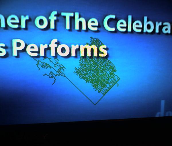

New member Username: WaazzuupPost Number: 1 Registered: May-05 | I have a Sony KF-60WE610 LCD Projection TV. I have had it for about 1.5 years. I turned it on tonight and I noticed these strange yellow lines. Any ideas? ![]() |

New member Username: WaazzuupPost Number: 2 Registered: May-05 | nothing was spilled on top of the display. Are you being serious about spider webs inside? I'm not sure, but I think we bought an extended warranty through the store that we got it from. Hopefully they can repair it or give us a new one. |

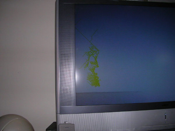

Unregistered guest | Same thing with 50we655 but much bigger print of the yellow. Still waiting for sony to do something set was new on christmas |
New member Username: WaazzuupPost Number: 3 Registered: May-05 | It's actually worse now ![]() |
New member Username: HillboyPost Number: 2 Registered: May-05 | Mines bigger than that :-) and it is growing. Sony has no tech in our area and I am still waiting for them to cal back. Are we the only two with this problem |
Bronze Member Username: PugcharlieN, E, PA USA Post Number: 62 Registered: Feb-05 | Could this be an LCD panel? |
HD Fanatic Unregistered guest | I suppose it's possible that it could be a LCD chip/panel problem. I'd be willing to bet that it's something with the screen itself. An easy way to find out is to pop the screen off and take a look inside. If the web image is not visible on the mirror inside the set, then it would have to be the screen. This is not anything I have seen before. Keep us all posted when you find out what this is. |
New member Username: HillboyPost Number: 3 Registered: May-05 | I will keep all of you informed. I will not pull the screen as it is under full warrenty and they can fix it or replace it. |

BertJ Unregistered guest | My Sony 50WE610 which is 1.8 years old has the same defect. Same type of pattern on the lower left quadrant. Out of warranty. Sony Customer service suggested that it was a normal occurence. I am very unhappy at the moment. |

Unregistered guest | I have a SONY KF-42WE610 1.6y old. No problems up to 7/1, turned set on 7/2 same yellow etch-a-sketch likemarkings on lower R quadrant. Anyone get resolution or answers from SONY? |

New member Username: Billwang88Long Beach, CA USA Post Number: 2 Registered: Jul-05 | I found this posting from Googling "sony lcd projection tv problems"... Display Problem, December 2, 2004 Reviewer: Mark Seiwert (Wichita, Ks) - See all my reviews My Sony LCD large screen TV is just over one year old. It has yellow splotch about mid upper screen. A close inspection of the screen reveals a circuit board trace like pattern that is yellow. The set has not been abused or exposed to temperature extremes. A UPS should be used with these units to keep the lamp cooling fan powered in case of a power failure. The lamps are at least $250.00 I would definitely recomend the extended warranty. Is the technology not proven on these large screens? Is the screen going to fail after 3 years when the extended warranty is expired? Sony will not stand behind their product after the warrany is expired. (mine is two weeks out) Other than the display problem the unit has performed flawless. It's a lot of money for a TV that doesn't last more than a year!!!! |
New member Username: Billwang88Long Beach, CA USA Post Number: 3 Registered: Jul-05 | and this one on a KDF-60XBR950... Reviewed by: cedricreynolds from NH on May 4, 2005 Rating: Experience: 15 Months Strengths: excellent picture from the box, no burn in Weaknesses: has design defect non-removable Lexan cover gets dirt on backside where it cannot be cleaned Summary: Sony offered to buy back for $1000 less than paid due to known design defect after 15 months citing depreciation. Parts replaced but nonconformity not corrected violating warranty. The Lexan cover seal leaks. Fan inside forces air past seal causing dirt smudges up to 6" long around perimeter of screen at attachment points. Sony replaced Lexan cover, then whole TV, then Lexan cover again waiting for warranty to expire. New cover replaced 4/05 has same seal design and will get dirty. Will be real obvious at 2000 hrs which for me is a little over 2 months of use since I watch it all the time. Other than the dirt and clouding of the screen, one of the best pictures available when new. Technology is subjectively surpassed with new gen 2+ DLP sets by Mitsubishi and Samsung. Know of one other also on 4th Lexan cover and 2nd TV from Sony. He has seen 2 other posts on internet reviews with the same problem. If you buy this TV it is a matter of time before you have the same problem. Email me if you have the same problem. ___________________________________________________________ Now, granted, these are isolated instances, and there are plenty of raving reviews out there on SONY products, but I just thought this gives me enough reasons to consider Samsung's DLP products. So I did some digging by Googling "samsung dlp tv problems" and found some reviews from this site... https://www.ecoustics.com/electronics/forum/home-video/14343.html Is there anybody out there who can make a reliable $3000 TV? |
Unregistered guest | I have the same problem with my screen. Purple lines like roadmaps. The lines will become less and less while you have your set on longer and longer. I left my TV on for the whole day and all the lines disappeared. Then I turned it off and let it rest for a night. The next day I turned on the set and there's no lines any more. Everything is back to normal. I don't know what the problem is or why this solved the problem, but it's been OK for a month and a half now. No need to replace anything! |

DFOrr Unregistered guest | My 50" KF50WE610 has the same problem. Purchased in Oct 03, problem appeared in May 05, 19 months. Tech tried cleaning twice, Sony advises to replace optical unit, $800 part + labor. Sony is giving me the runaround, but is offering to cover half the cost. I'm waiting for a Sony Customer Service supervisor to call back tomorrow, as I am now going for full coverage, even though it is out of warranty. The tech described the problem as an LCD failure, not dirt, as it can not be cleaned, it is inside the LCD surface, somewhat of a blackened appearance on the interior of the blue LCD. |
Unregistered guest | I also had the problem on my 1.5 yr old TV, a patch about 2" x 4" , that all the previous posts have described. The first time it appeared, the patch gradually decreased in size, but didn't disappear entirely. The next day, it reappeared in a larger, denser area, but gradually decreased in size over several hours, until it disappeared entirely. Checked with the Sony-certified technician, who said the light engine had to be replaced, but managed to get Sony to pay for it. He changed out the unit, and the problem went away. Will it come back? I don't know. The fact that so many others have had the same problem suggests that Sony will ultimately have to acknowledge a basic design defect, make a correction, and offer it as a recall item. |
