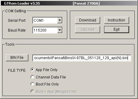

help please..new at this have a 2700a pansat what are the steps updating the new bin where do i get the software and the right bin and whatever else i need...thanks
Username: As400
Post Number: 82
Scott -
Download Procedure for Pansat 2700A /2700E
1.Connect RS 232 Null Modem(#2,3 crossed) cable between the receiver and PC.
2.Turn the receiver power OFF. (from the back panel)
3 Open the GTRom Loader V3.35 (Pansat 2700A).
4.Click BIN FILE and select the Bin File to be downloaded.
5.Turn the receiver power ON and as soon as you see the 1st green light click Downlaod.
6.Do not interrupt the receiver power while downloading.
7.Press OK after Download Complete!! appear on the PC screen.
8.Receiver will reboot itself.
9.Go to the Parental Control Menu
10.Select the second PIN and enter "0000" .
11.Select "Set default key"

Where to get GUI GTRom Loader
http://www.pansatusa.com/download/2700A/2700A.zip
