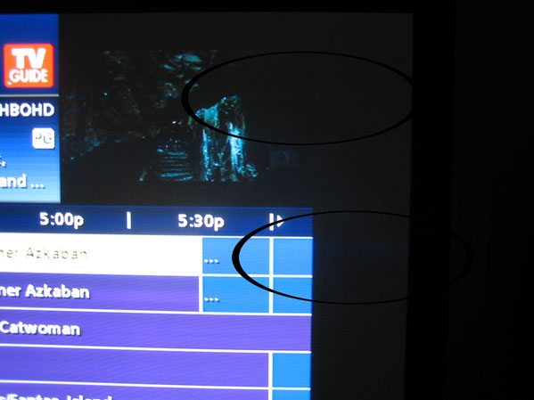

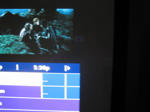

OK..... Comcast didn't work with HDMI to the reciever for me. And it disables the digital audio ports when you plug in the hdmi cable. Your cables will be fine if you get the hdmi from the DVD to the reciever and the reciever to the TV if it's HDMI. Look at monoprice.com (i'm using their cable and monster cables and I see no difference. it's a digital signal) As for the analog cables (componet) you really should use better cables.. Cheap cables will cause color banding. I can post examples if you need proof.
Username: Tenettech
Post Number: 10
please post proof...I'd like to see the difference as I bought a lot of cables from monoprice also. Haven't used it all yet.
Username: Cuylar
MN USA
Post Number: 73
here... this is the rainbow effect.
