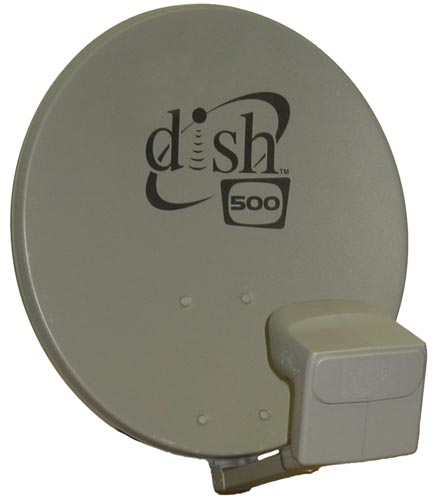

Got myself a DISH500 dish set complete with duo LNBs... is there now a chance I can pick up the international channels from Echo 9? I have my receiver set:

Username: As400
Post Number: 18
the more I read the interesting this becomes... so I learned that as you said.. Echo-9 is linear but Echo7 is circuilar... I would need a linear LNB to get echo-9 packages. My DISH500 dish has two LNBFs but I dont know if one or both are linear... I have to assume that both are circular. Any way I can identify these LNBFs?
Thanks again
Username: H3lt3r_sk3lt3r
Post Number: 581
@IBM
They're both circular, because dish500 is used for 110 and 119. And it's probably a legacy twin (do you have a DP logo on the lnb casing?) which might not work with your FTA, unless you have a dishpro twin.
Username: As400
Post Number: 19
both say "Dish Digital LNBF"
and yes, I noticed after my last post theres a 110 and 119 sign engraved on the fork that holds each LNB. So you're right, they are for 110 and 119 sats and therefore both are circular LNB. I picked up this dish from a friend neighbour whom was about to trash it. Good deal, I see myself buying a linear LNB now.
