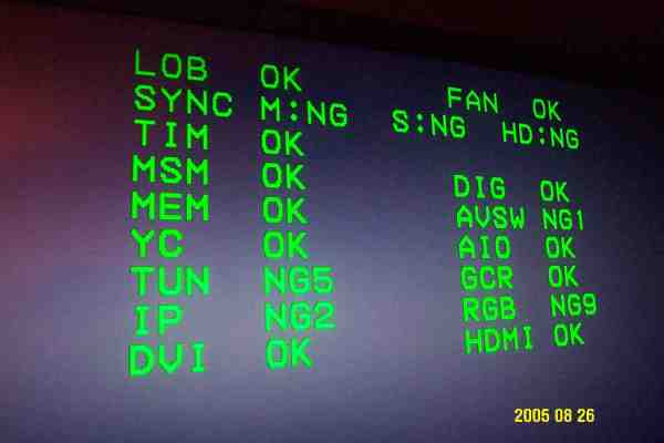

Rex & Ted-
The JVC has 3 variable speed internal fans. Not all 3 run at the same time or speed. Could the ambient air temp be higher causing the fans to kick in a bit more? There is also an easy way to see if the fans are operating properly.
Go into the service menu.
select option 2 "self-check"
The top line on the right will say "FAN" and either "OK" or "NG". If "NG" is displayed, then you might have a problem.

Gentlemen,
Replacement Bulb arrived today... and the thing actually WORKS!,
Initially there was NO sound .. Turned out CENTER CHANNEL was ON.(duh)
Trying to get into SERVICE MODE..(actually trying to enter "SELF CHECK MODE").
Remote set to [TV], and [VCR]... pressed the [SLEEP TIMER] key, displays 30 minutes, then pressed[VIDEO STATUS], and the [DISPLAY] key simultaneously.. SERVICE MENU should appear, right?
Tried selecting 30 minutes on the sleep timer, then pressing 'OK", and then hitting the other keys...
What's the "trick"?
Username: Wearenotalone69
Post Number: 17
Registered: Aug-05
Must be a TYPO in the SERVICE MANUAL.... on page 29 about the self-check it says 30 minutes... on page 19 it's saying 0.
Post Number: 18
Registered: Aug-05
Ah, fiqured it out, you have to press [VIDEO STATUS], and the [DISPLAY] key simultaneously..
WHILE the SLEEP TIMER is STILL displayed.
Post Number: 19
Registered: Aug-05
OK... because of a blub failure... are these values NORMAL?
Getting ready to clear the error codes...
Post Number: 20
Registered: Aug-05
OK.. RESET the codes.... using built in tuner of TV itself to tune OTA stations (NO HD TUNER hooked up, nor ANYTHING else.)
SYNC M:NG
S:NG
HD: NG
Are the NG's being displayed NORMAL??????
