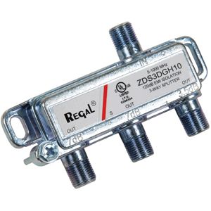

New member Username: ShebalordPost Number: 1 Registered: Nov-08 | Cableguy: Can you recommend me splitters that I should use and a directional coupler to use with Time Warner digital cable service? Right now I'm getting a few problems: 1) Internet seems slower than normal. 2) In room 3, Digital Receiver STB is used but gets fuzzy picture and missing channels. I only tried using one STB at any given time but with the cable modem always on. Please see the attached pic for my setup. Thanks in advance! |
New member Username: ShebalordPost Number: 2 Registered: Nov-08 | ![]() |
Gold Member Username: TapemanNew York City in-HD, NY Post Number: 3702 Registered: Oct-06 | There is yor problem: "In room 3, Digital Receiver STB is used but gets fuzzy picture and missing channels." Plus yo possibly shorting entire house wiring Try to use a 4 way splitter going to all yor house wiring (i.e. what's going to all coax cables at yor basement or garage etc.) Out of the wall use a 2-way splitter 1- To yor cable modem 1- To yor Digital Receiver |

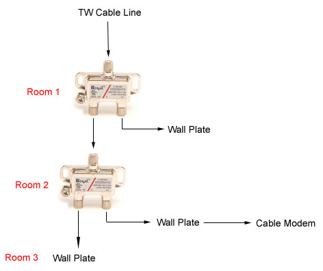

New member Username: Hard2qillPost Number: 1 Registered: Sep-10 | I have Time warner .....cable and internet coming in on one line ...i have a 3 way time warner 5-1000mhz splitter in the box......one line dedicated to the internet .......second line to the living room and first bed room via a two way splitter......the third line runs to the 2nd and 3rd bedrooms via another two way splitter.....most of the lower channels in the living room are clear .....the from around 25 up they get fuzzy and grainy........the all 3 bedrooms have snowy, grainy pictures on all channels...... can you guys help me ? |
New member Username: RamonsPost Number: 5 Registered: Mar-10 | Hi hard! Do you have an amplifier installed? If not, that may be one option assuming two things: - cabling is OK (your own cable from Home Depot, not the cheap stuff from TW) - splitters are OK (TW splitters work, but there are clearly better splitters) - signal coming in is OK (TW's signals are often quite weak) If you install an amplifier make sure that you use a two way splitter right before going to the amp. One line is for internet, the other line goes to the amp, from there on to the splitters for TV. You cannot pull the internet line through the amp, that won't work. |
New member Username: Hard2qillPost Number: 2 Registered: Sep-10 | Dave... i found an bidirectional amplifier/splitter with a 7dB loss and 5x amplification for like $58.99 by Electroline. It has 4 output ports. EDA-2400 Would this work or do you suggest another? |
New member Username: RamonsPost Number: 6 Registered: Mar-10 | Hi hard! I haven't used any of these amps, but based on the description it should work. I didn't have one of these installed and when TW hooked the cable up the tech mentioned that they cannot go through the amp for internet. I pulled in a new cable exclusively for the cable modem and that goes off the first two way splitter. Do you have currently an amp installed ? If not, than adding one may be the way to go. With so many splits you have quite some loss. Does Internet connectivity work for you alright? If yes, then giving it its own cable will make things only better. How old are the cabling and the splitters? As mentioned in my first response, that is something to check no matter what. There is not much point in trying to compensate bad cabling by installing a big amp. You may also try and put a new 2way splitter into one line and see if that makes any difference. If yes, replace the other one as well. You can also try replacing the 3way with a 2way for testing leaving the internet line off. That is a bit comparing apples and oranges, but it will give you a clue as to where to work on in case it gets tremendously better. One thing you can try as well is loosen the F connectors on the splitters and the wall plates. The TW tech that installed our cable overtightened some connectors and loosening them down to hand tight made for better signal. Lastly, call TW. You pay them dearly each month and the least they can do is make sure stuff works everywhere. If they mention that new cabling is needed do that yourself. The TW tech who came to my place said their cable sucked and the one I got from Home Depot was ten times better. Good luck! |
New member Username: DylangerPost Number: 7 Registered: Sep-10 | do you have a link to that amp?I would suggest use a antronix or commscope amp. Most cable companies do not use electroline amps because they fail at a much larger rate then the amps mentioned above. Buy commscope or beldin cable, DO NOT buy anything from home depot. the TW guy you had at your house did not know what he was talking about. Your internet, you want before the amplifier but you also want that to be 7db down. A 2 way splitter is not going to be enough loss to make your modem stable, it IS going to flap and cause your service to be spotty. Do not buy your splitters from the hardware store or your big box. If you look for regal or antronix on ebay they are cheaper and a better product. Most cable systems are 1ghz systems now and the splitters you buy from those stores are rated to 700mhz or 900mhz. this does not seem like a big deal but it is when you are trying to get off air HD's, set top boxes, cable modems, or EMTAS. just a thought though, if you have questions on what to buy just ask me. |
New member Username: RamonsPost Number: 7 Registered: Mar-10 | Hi Dylan! Well, that depends. Internet is working very stable for me. And signal loss is not only from splitters, but also from cable runs. Besides that, the cable from TW is only double-shielded. The one I got from Home Depot is triple shielded and has a better dielectric insulator. I did cable TV, antenna, and satellite dish installs as a profession (although that is some time ago) and the Home Depot cable is decent cable. Can you buy better cable at a much higher price? Sure, but that is something to consider when I have to pull extremely long runs and any less in loss and distortion is key. I do agree that the flashy brand names typically sold in stores are not necessarily the best you can get. There is no relationship between quality and popularity (best examples are Microsoft Windows or Bose). |
Bronze Member Username: DylangerPost Number: 11 Registered: Sep-10 | Well to be coming off a 2 way and having your cable modem stable you either have junky signal coming in from your system or a junky drop to a room. Not too often have I ever seen a modem be truly stable coming off a 2 way. How long ago were you in the profession? From what I am reading people on this board are pretty much telling people to go buy pre-made 50 foot pieces of cable and telling them to use that stuff. If you house gets inspected by a true inspector, your house wont even pass because most of that stuff isnt even ul listed. Double shielded cable is perfectly fine. I find that quad and tri shielded fails on a much larger basis than double shielded. that could be to do with the region I am in though. I in fact cringe at the idea of any home owner running their own cable. Its never done correctly and almost always daisy chained. |
New member Username: RamonsPost Number: 8 Registered: Mar-10 | Line from the pole is coming into the basement, into a 2way, one line goes in a continuous run straight to the modem. That is the new line that I put in, because I wanted to run it through the wall inside the house and not have the TW guy do a hack job on the outside wall. Since they powered on the signal phone and modem are rock solid. Can't say that about the old cabling and splitters, which I need to check in my place, but aside from a few blocks here and there it is something I can live with. I did an apprenticeship in Germany for 3 years and finished best in the county. I built about 150 satellite installs and at least over 300 cable hook ups. Every single satellite installation that I did still works fine to this day (usually installed the Kathrein dishes prepared for digital, not this garbage the the US dish companies nail into people's front yards). I left the profession ten years ago when I moved to the US. That said, the cable I got from HD passed my test and it is of decent quality. It works and it works reliably on a 30 ft run. I had the TW guys crimp the connectors on it, because that is the way to do it rather than the manual install where you twist the plugs on. But yea, just because my cable modem works fine and comes from a 2way I must have done something wrong. Makes me wonder how good your advice is. |
Bronze Member Username: DylangerPost Number: 12 Registered: Sep-10 | My advice is fine, After all I AM CURRENTLY EMPLOYED IN THE INDUSTRY. Ive been working on anything from many different HFC plants and fiber plants. Ive built plant, both HFC and Fiber. I dont get service calls over my quality of work, so I think my advice is fine. chances are you did youre installations before reverse path was really much of an issue. Satellite is a joke, FYI. |
