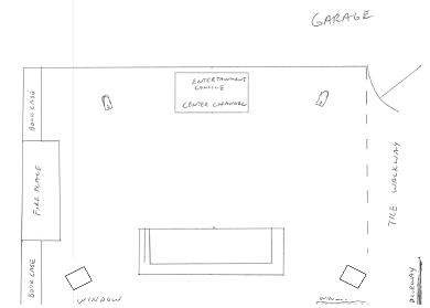

New member Username: TallqballPost Number: 3 Registered: Oct-10 |
Hopefully this upload works of my sketch. There is a door and a doorway on the right side, windows behind the sofa, and fireplace and bookshelves on the left side. Thanks for your help! |
Platinum Member Username: PlymouthCanada Post Number: 15384 Registered: Jan-08 | OH I see! You can put your speaker like this direct on the floor for the 805s or the DS8s on the wall, I prefer the floor solution but you are the only one to know if you want them on the floor. ![]() |
New member Username: TallqballPost Number: 4 Registered: Oct-10 | I was working on a deal on some close-out DS8s, but one advantage of a floor solution is they can go in front of at least one window. Think I need to look into some good heavy drapes too... Thanks for your help! | |
Platinum Member Username: PlymouthCanada Post Number: 15387 Registered: Jan-08 | Tallqball I prefer the floor solution for 2 reasons, you can directed the speakers to you ears then you will have no reflection on the wall like a wall solution. |
