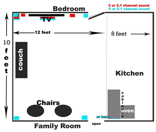

On and on with the technology...when is this madness going to stop?
Thanks for chiming in on my quest for finding the perfect receiver in my small modest listening/viewing room.
MY BUDGET: I'd like to say I don't, and couldn't afford anything over $600.00 on the AVR. The HSU research speakers I'm thinking about getting, are about $500.00, So for me, I think the total amount I would spend on this is about $1100.00, which is about $1100.00 more than I want to spend right now....lol :joke: hehe
I know there are better than HSU speakers out there, but like I said before, to me, they do sound crisper than the Polk 6880's I heard, and the HSU sub is 150w vs the 100w elongated sub that the polk has with their 6880 package.
The 10'x12' room just ain't big enough for the audiophile set of the new onkyo 9.1 channel setup coming out soon. I also head that Onkyo 707mwill be out soon. Originally, I was only going to do a 3.1 channel, but opted for the three additional speakers for the 6.1.
The fronts and rears... I was already planning on mounting them in the higher corners, so that "falling effect" won't help me if the 9.1 speakers are meant for going higher than the floor standers, which I do not have. Should I consider the new 9.1 anyway, because of the new processor, or will that make no difference unless I ultimately have all 9.1 speakers?
Unless the new Onkyo's that come out do not start over $600.00, or less, then I think I'm going to stay with the present three choices I have stated on my previous post.
The AVR's don't have to be THX certified, I need something that will add more effectiveness to watching movies and listening to mp3 music. (ipod or mp3 disc) And had HDMI Pass through and the DTS:NEO:6 or the DTS-ES 6.1 feature to utilize that 6th rear-channel speaker.
Another note. Am I sacrificing worse surround sound by only having the speakers up high (around 7 feet) as opposed to having fronts on the floor?
Whatever I do, I'm sure they will sound much better than my friends' Sony HTiab avr/speakers which are also mounted in his corners.

Don't pay any attention to the 3.1 or 5.1 text. I am going to use a 6.1 system, using a 7.1 ch. AVR
