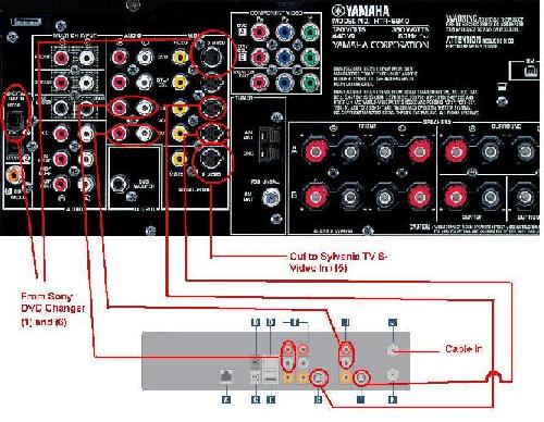

Ok I understand everything so far... But I was kind of hoping for a diagram of some sort between the 4 boxes described in my first post (which included modal numbers you could lookup for a view of the back of them)...

This may be more confusing than simply writing but see the attached file for your diagram. I can only copy the pictures of the Yamaha and the TIVO. If you need them you can get pictures of the Sony from here:
http://www.sonystyle.com/webapp/wcs/stores/servlet/ProductDisplay?catalogId=10551&storeId=10151&langId=-1&productId=11039419
and the Sylvania from here:
http://www.manualshark.org/manualshark/files/21/pdf_14978.pdf
From your Sony take the optical out (1) and the S Video out (6) to the indicated location on the Yamaha.
From the Yamaha take the indicated S-Video out to the Sylvania S Video in (15).
All the rest should be described in the attached.

Thanks for the help! I'll try this out as soon as my banana plugs (Nakamichi) from HK show up. This diagram is exactly what I was looking for! This should be really easy to setup now.

The banana plugs finally arrived today from Honk Kong (only place to find inexpensive ones but still decent quality). Anyways, I followed your instructions and diagram and everything is working without a problem!

Ok guys, I got another item I want to add to my home theatre system. I just signed up for more cable channels, which now requires a digital cable box. In this diagram, How does this get setup with the rest of what I have here?
