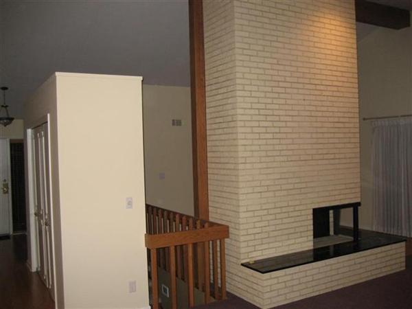

New member Username: BrandonbPost Number: 1 Registered: Aug-07 | Hi All, Just moved to a new location and my old setup would not work here. With the living room design, my only option was flat panel mounted on the fireplace. I just bought a 46" 1080p Samsung that is going to be delivered and installed in 2 weeks when all of our belongings arrive. I'm having a hard time figuring out how the everything will go together. There's two main problems I see. First, I don't know where to put the media cabinet with satellite box, receiver, and XBOX/DVD. I've attached some picture for reference. It would be nice to have it out of the way in a back corner, but with the design of the living room and fireplace by itself, I don't know how we could put it in a discreet area. I think we may have to resort to next to the fireplace where the stairwell is. However, I'm not sure how we'd get the cable line for satellite there or how you'd wire the surround speakers from there. Any suggestions for media cabinet placement and ideas on making it work? Second problem is speaker setup. I currently have a great setup in our old home with my Mirage Omnisat surrounds and JBL center. I know the 2 rear will mount fine in the back no problem. My concern are the front and center channel speakers. Where can I mount them? I really don't want to go to the ceiling. It's vaulted and that would be too high and likely throw off the acoustics. Also, troubleshooting them would be a nightmare. I don't know where else unless they can be mounted on the fireplace. Any ideas? Any help or advice would be greatly appreciated. Thanks! ![]() |

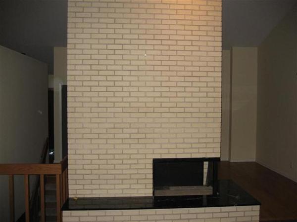

New member Username: BrandonbPost Number: 2 Registered: Aug-07 | Here are 2 more pictures... ![]() |
Bronze Member Username: Db_audiofileLa habra, Ca Usa Post Number: 21 Registered: Aug-07 | Brandon, Wow! If it were me, I would mount every thing on the opposite wall and use back to back couchs. Lack of accessable electric is a problem. The rear speakers I would mount on the sides above the curtin line. I am going to assume that is real brick and not just a fasaude. Also the recessed lighting looks to be strong. Change the bulbs or put them on a reostat. My reason for side mounting the rear speakers is that it is easy and the sound is like a real theater. Good Luck, your friend, Db |
New member Username: BrandonbPost Number: 3 Registered: Aug-07 | Don, thanks for your advice. We're really not trying to turn the room into a home theater. It's a living room first, home theater second. The only way to make it work is with the TV mounted on the fireplace given our furniture. So if our only option is putting the TV on the fireplace, what is the best way to mount the front and center speakers? Any other ideas or options? Luckily, the lighting above the fireplace has an independent switch so we can have those 2 off and the rest on if need be. Thanks! -Brandon |
Bronze Member Username: Db_audiofileLa habra, Ca Usa Post Number: 32 Registered: Aug-07 | Brandon, I understand. I have designed and installed these systems for over 12 years. Living roon first. I am going to assume that the brick is real brick. Do not worry about heat from the fireplace, you will be ok with either LCD or Plasma. I would use cement ankor bolts to thin frame standard mount. (vesa standard). On the mounting bracket you can buy an attachment that will hold the center channel. Side mount left and right channel speakers to the side if your fire place. Small speakers will do. Take a small chisel and carve out the grout between the brick and the wires between the bricks and re-grout. That will hide the wires. Mounting brackets extend about 4 inches from the brick wall. Run the wires down the length of your oak rail. (use crown moulding to hide those wires. This will allow for easy upgrades in the future. If you are a little more exoitic, you can buy a picture frame and place it around your Samsung. It will just look like a picture. I do not know how big your front speakers will be. But most brackets should hold it. On the left side next to the fireplace, looks like a closet. I would either cut a hole in the cabinet and flush mount the rest of your componets, or open wall rack on that cabinet. This is only a thought. Do not anyone tell you mounting above the fireplace is a bad idea. 60 % of my installations are done that way. Good luck, your friend, Db |

New member Username: BrandonbPost Number: 4 Registered: Aug-07 | Thank you both for your input. Westcott - I did tell Don how I wanted it. I appreicate that he tried to work with my needs and not tell me how I was wrong. While I said living room first, I lied. It's actually wife first, living room second, and then HT. Putting the TV on any other wall would ruin the flow of the living room. The room is just too long and narrow. While I appreciate you posting on this thread, it would be more valuable to me if you would mention what option you think is bes, even if it is putting the TV on the other wall. What do you think I should do? All - The fireplace is 81" (6ft 9in) across. My front speakers are Mirage Omnisats that can mount on a single screw. Would I be okay mounting these in the fireplace or should I put them on wall to each side? Also, can I run speaker wire up into the brick of the fireplace (since all the components would be next to it)? Thanks -Brandon |
Silver Member Username: HuronPost Number: 157 Registered: Mar-07 | WOW brutal, first, it sounds like this guy whats it one way and thats it. second, my first impression was better pictures please so we can help you exaust all posibilities, but if not is you speakers rear ported, if I was going to mount them to a wall I would look into getting new matching speakers that would be best for this situation. I have to say though, I think you should give better pic`s and let us give sujestions on other ideas, and is this the only room you have to work with? |
New member Username: BrandonbPost Number: 5 Registered: Aug-07 | This is the only room I have to work with. What angle/kind of pictures do you need? I can take anything and upload them for you, just let me know what would be more helpful. Thanks! |
Silver Member Username: HuronPost Number: 158 Registered: Mar-07 | and what is the room size, and better pic`s I mean stand at the back of the room so I can see, and I dont think I agree on mounting the rear speakers that way untill I see open pic`s and room size |

Silver Member Username: HuronPost Number: 159 Registered: Mar-07 | is that a closet on the left? I think it would be really cool to have the equipment sunk right in there flush, then all the wires can be contained |
Silver Member Username: HuronPost Number: 160 Registered: Mar-07 | are you sure you want your stuff mounted to the fire place, not that it cant work, but you ow it to yourself to take a few days and exaust every posibility. the first three pic`s, thats the way you are thinking that you might want to mount everything to that side right? if yes then what is the room size from the fire place to the back and is the fire place centered or off set sometime pics can be deseving |
Silver Member Username: HuronPost Number: 161 Registered: Mar-07 | take one pic center backed agenst the back wall looking were the tv and speakers might go, then center standing on the fire place were the tv might go looking center back were the rear speakers might go, or maybe im just nuts and like pictures of plain walls |
Silver Member Username: HuronPost Number: 162 Registered: Mar-07 | if that is a closet on the left the sub could be tucked under the equipment, front firing, exposed but flush with the wall, just thinking |
New member Username: BrandonbPost Number: 8 Registered: Aug-07 | Picture 2 is standing against back wall facing fireplace, where TV would go. While I like the idea of using the closet for components, I don't think we'll want to cut it up and mess with it. |
Bronze Member Username: Db_audiofileLa habra, Ca Usa Post Number: 38 Registered: Aug-07 | Brandon, thank you for your support. Is your fireplace offset from your viewing location? The battle of Living room Vs theater room, I have seen this a million times are you going to win? (lol,lol really lol. good luck your friend, Db |

Silver Member Username: HuronPost Number: 163 Registered: Mar-07 | OK Don calm down, looking at what I see your only alterative would be to revers everything, but as far as this way go's, 1. what is the distance from the fire place to back wall? because im thinking the rears should probably be on stands, or on the back wall corners toed in. 2. do you listen to music as well? because this will determine the height of rear speakers. 3. how wide is the fire place? Im thinking costom shelves on the sides, or front face as far as you can get the front speakers apart, on the sides would allow for deep book shelve speakers like pinnacle diamond,or wharfedale, something that would fill that room. or go for mountable flat speakers, ether way matching speakers would help. 4. once again is there an off set on the fire place that would hinder room aligment? 5. https://www.ecoustics.com/electronics/forum/system-showcase/336284.html this is my room and there has been changes, and yes I live in a trailer with psychedelic carpet, but anyways, that use to be a built in china cabnet, so ether I was going to go gaay and buy china or turn it in to a home theater, thank god for home theater, any ways my point, if I ever had one, is its nice to have everything tucked away that can be and cutting in to that closet for your equipment would be very trick and wouldnt take that much. 6. sub should go left side of fire place. 7. wow now I understand the photos the wall of windows and certains is the back of the room, now I understand what westcott was saying, I had to look at the ceiling to figure it out. wow I have a loss for wards |
Silver Member Username: HuronPost Number: 164 Registered: Mar-07 | waite, I have an idea what is the distance between the fire place and the back certains and windows? |
New member Username: BrandonbPost Number: 9 Registered: Aug-07 | The distance between them is 13ft. |
