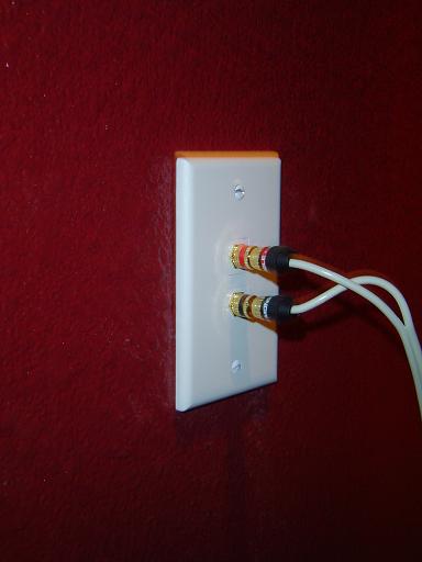

Whats everyone using at your surround speakers for faceplates? What about at the system end? After moving my tv a few times, id like to make a modular wall connection, but damn, just for my five speakers, id need a 10 port faceplate.

Do you mean wallplates for AV gear (binding posts, banana connects, RCA connects?) If so, I use the Quickport line from Leviton:
http://www.levitonproducts.com/catalog/dept_id_561.htm?sid=02786EA14D3F24D39363B 98D53295B16&pid=1208
Username: Iowa_hifi
Like this...

Joe's picture is much better than his link. I did this in my home and went through a lot of experimentation before I was satisfied. The picture has it right. Unfortunautely, the Leviton products (available at my local Home Depot store) have the connectors mounted on snap-in quick inserts. The Leviton are made this way as a timesaving product for electricians who don't want to spend any more time than they have to, even if this means that the quality is compromised. These inserts have a very nasty habit of coming loose and hanging loosly on the wall. Looks bad, and if your connection isn't very tight, they will seperate. I hate them.
The picture, however, shows a solid plate (no inserts) which provides a firm mount for the connector. The ones I use are Decora type, rather than the Leviton. I heartily recommend them as they provide a stable platform for the connectors. Here is a source I used that is reasonably priced and good quality for what you need:

Username: Iowa_hifi
Hawk - That picture is of my home install. It is a Leviton plate and insert. I've not had any problems with the inserts but I do see what you mean and over time the inserts may become loose, especially if they are manipulated frequently. That being said, I may have to revisit my decision and take a look at the Decora line you referenced.
