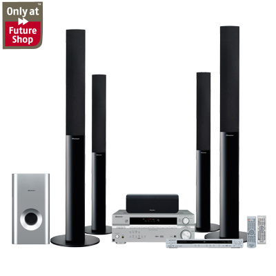

Can ANYONE out there tell me anything about this new 5.1 HTIB with seperate receiver, DVD player, HDMI? I take it that it has just come on the market, as there is nothing about it, even on the Pioneer website. It is sold through Futureshop stores in Canada at $700. the system is included with my Hitachi 50", which is being delivered on Friday. I hope the 4 tallboy speakers sound much better than the usual cubes included in similar Pioneer packages. Here are the specs:
Mfr. Part Number: HTP-55HD
# of Speakers in Package, Including Subwoofer 6
2-Way Centre Speakers Yes
2-Way Main Speakers Yes
2-Way Rear Speakers Yes
Component Video Input/Output 1 Output
Disc Capacity 1
Dolby Digital EX No
Dolby Digital Surround Sound Yes
Dolby Pro Logic II Yes
Dolby Pro Logic Surround Yes
DTS Decoder Yes
DTS ES No
Frequency Response 45Hz - 20kHz
Front-Panel A/V Inputs 1 Front Audio In (Mini Jack)
Headphone Jack Yes
Hook Up Wires Included Yes
Included In Box See The Features Section
Includes DVD Player Yes
Magnetically Shielded Yes
Multiroom Capability No
On-Screen Display Yes
Preamp Outputs No
Product Warranty 1 Year Parts & Labour
Product Weight 8.6 kg
Progressive Scan DVD Yes
Remote Type Standard
S-Video In/Out 1 Output
Speaker Colour Black
Stereo Audio Inputs/Outputs 3 Inputs, 1 Output
Subwoofer Colour Silver
Subwoofer Power 100 Watts
Subwoofer Size 6.5"
System Colour Silver
THX Select No
THX Ultra II No
Total System Power, Including Subwoofer 1000 Watts
Video Monitor Output 1 Output
If anyone has any info about this, I would LOVE to hear from you! I listened to it in the store and was blown away.
