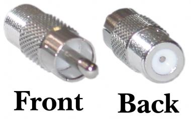

Then screw on these to both ends:

I know it seems like a lot of trouble to use standard F connectors on the coax and then a converter to change the F connector to a male RCA connector, but finding an RCA connector made for DIY installation on coax is difficult. Local suppliers just won't have them, catalog or web sites only.
So, you will need two "F" connectors for the coax, either for RG-59 or RG-6, and two female F to male RCA converters. The picture in the the previous post shows the F to RCA converter. When you get all this neat stuff, gold plated is preferable, but the nickel plated stuff will work just fine, it's just not as resistant to corrosion many years down the path. Follow the installation instructions on the back of the F connector pack and you should do fine.
