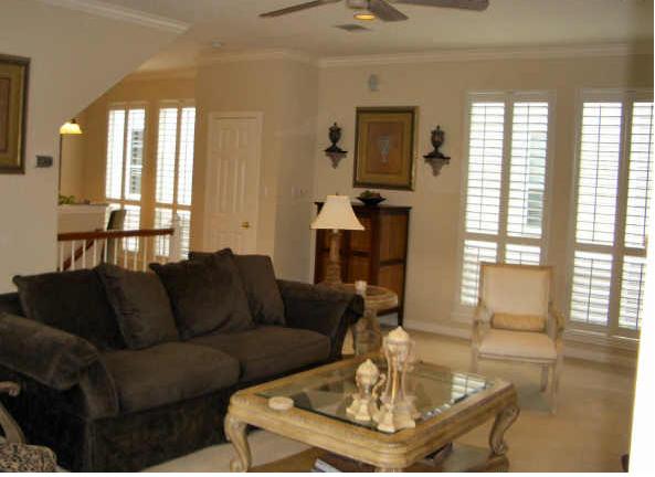

Hey everyone. I just bought a new townhouse and an starting to plan my home theater system. I plan on getting a plasma and setting it up above the fireplace, but dont know where to put the center channel. I was planning on putting the LR on either side of the fireplace, but am unsure about the center. Any advice would be great. I've attached a photo to give you a better idea of the setup.
On a sidenote, do you think above hte fireplace is too high for the plasma? I'm in a tight spot because this is hte only room that has space for a nice setup!!!!Upload

From what I can see on this picture, I think your couch is only 4 - 5 feet away from the placement of the screen, yet the screen is about 5-6 feet high. If you end up getting a 50 inch plasma screen, it would be akin to sitting close to the screen in a theater watching a movie. That can't be a good experience. All I'm saying is give this some thought.

Stof, you make a good point. The more I think about it I may try and do something like in the "His and Her" room post. The only problem is that on the walls on either side of the fireplace are large windows. I really didn't want to block them, and dont know how good it will be to have a light source right behind the television. But I think I may have to.
Username: Lones0me4
Here are two more pictures of hte side walls and windows. Also, this is the old owners furniture. I am going to get all new furntiure, so am open to all possibilities.

To give a little more information, the couch in the picture was the previous owners. I need to get new forniture for the room. However, I did some measuring, and the back of whatever couch I get will be 11 feet from the mantel....quite a bit more than 5 or 6 it looks like. The previous owners had the couch pushed up closer than need be.
As far as the fireplace, I don't think I will use it much if any (I'm in Texas), so the heat issue is not a big deal. I'm a single male right now, so having nice speakers is more important to me than having the asthetics of the room. Maybe that will change if I get married!

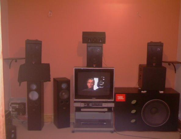

Well the front loudspeakers should be placed at the same height and should all be on the same horizontal plane, they shouldn't be placed to high, very to the ceiling will kill the sound imaging, or rather you will playing around with what's called psychoacoustics, the way we perceive sound.
Take a look at my home cinema; it may not look smart, but its sure sounds like I'm in the Empire Leicester Square.
