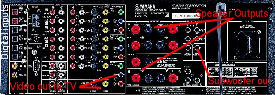

Silver Member Username: DaedilusPost Number: 121 Registered: Jun-05 | Negative. Bose speakers are proprietary, they are 3 ohms which is much too low for any HT receiver. The Bose AM 10 system has a specialty plug it comes with that plugs into a DB-15 (15 pin D-shaped computer style connector with set screws on either side.) This plug should be used to input speaker level out of your Yammie receiver into the bose bass module. You will find each cable is individually labled on this specialty wiring plug. Please note that this cable also has a RCA line level for the lfe input to the sub in addition to the speaker leads. I dont like Bose, personaly, for a number of reasons, and this is one, but since you are stuck with them you will just have to deal with the added distortion and loss of definition that comes with sending speaker level out to your Bose amps input. ~sorry. ![]() |

Silver Member Username: DaedilusPost Number: 124 Registered: Jun-05 | Sure Np. consult figure 6 on page 11 of this manual: www.bose.com/pdf/customer_service/owners/og_am6_10.pdf Be sure to use digital inputs from DVD (and tv if available) to your amp so you have true 5 channel DTS sound going out. ![]() |
New member Username: BengPost Number: 3 Registered: Jun-05 | Thanks, just wasn't sure cause as you probably know Yamaha's guide instructs to connect the speakers to the "pre out" (next to the sub at your pic.) so I wasn't sure if I can connect the speakers as u showed in the pic without harming them Thank again.... |
