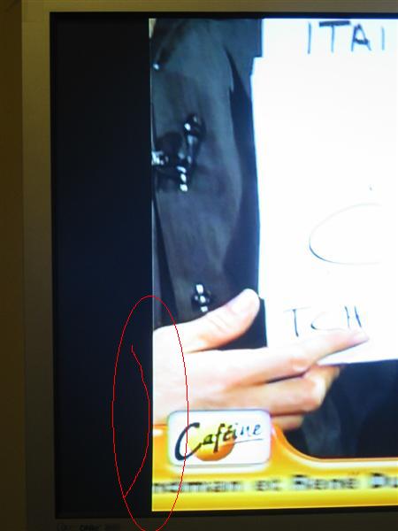

New member Username: JacouPost Number: 1 Registered: Jan-05 | Hi, thanks to all for the information provided in this thread, particulary the information regarding the fix for the audio delay (the fix worked on my HLN43651W1AX). I bought the HLN4365 at Futureshop last weekend for a very good discount (2000$ CDN instead of 3300$ CDN). I understand that this is an end of line model and this is why they are dumping the price. I bought the 3 years extended warranty from FS and I also have a 30 days no question refund possibility. Jury is still out wether I'll keep or not the tv. I have the following questions (btw, first language isn't English so it might not be as clear as I would like) 1) When I use the 4:3 mode (regardless of the source), on the side of the vertical bottom half of the TV, I can see that the line is not totally a line but more of a curve. Although it is not a big problem, now that I know that it is not perfectly a straight line, I have a hard time forgetting about it when I'm watching TV... Anyone else has this problem? (see picture attached). Is there a way to fix this? Would a technician be able to fix this? ![]() I guess i could be refunded but CDN 2000$ is probably the max limit I want to spend on a tv and as such, I tought that the HLN4365 was a good deal. As far as exchanging it, i guess that it will be hard to find another one as I believe that Futureshop has liquidated all their stock. I someone tells me that he sees the same curve and that it is normal, I will be happy and keep the tv. Thanks for your help Jacou |
New to DLP Unregistered guest | HI, I purchased a Samsung 50 inch HLP5063W last week and I have no problem with HD or SD, but when watching DVD (sony dvd player Connected through Component)I get terrible video noise(dots looking like snow)I had a Toshiba Projection tv(50 inch) and all my DVD 's worked perfectly with the Toshiba. I tried making Sharpness to ZERO still have lot of dots and Artifacts(waves). I don't understand if I'm doing any thing wrong or IF i need to change any settings. Please help. |
Klaus Unregistered guest | Jacou: I have an hlp4674w and notice the same curvature. It is very slight and only noticeable in 4:3 mode. My thought is that it may be the screen itself bowing inwards slightly or else a spherical distortion from a lens. |
New 5085 TV Unregistered guest | Jacou, I just purchased the Samsung Model HLP5085 and am having the exact same problem as you. I also purchased an extended warrenty from the store I purchased it from (Which is Best Buy). I gave them a call, and they told me that this is a pincushion effect, which a service technition can fix rather easily. My recommendation would be to give either Samsung or your local store a call and I'm sure they'll be able to fix the problem. |
New member Username: JacouPost Number: 2 Registered: Jan-05 | Klauss and New 5085: thanks for your quick reply. I'll call samsung to see if a tech can fix it. Now I just have to check (confirm in fact because I've been playing for a couple of days at halo2 without seeing any out of sync problem between video and audio through receiver) that I don't have the Audio out of sync problem when playing Xbox and I'll be very glad with my DLP choice. |
