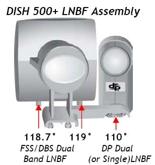

Any LNB can get 110-118-119 in same LNB.
The best 118-119 LNB is this one, you can see the 110 LNB on right side:
http://sadoun.com/Sat/Products/Dishnetwork/LNBF/148328_SuperDish_Dish500+_Repoin t_kit_with_129_Bracket.htm
The oval LNB on left side is the best because it is oval and give best signal on both 118-119.
