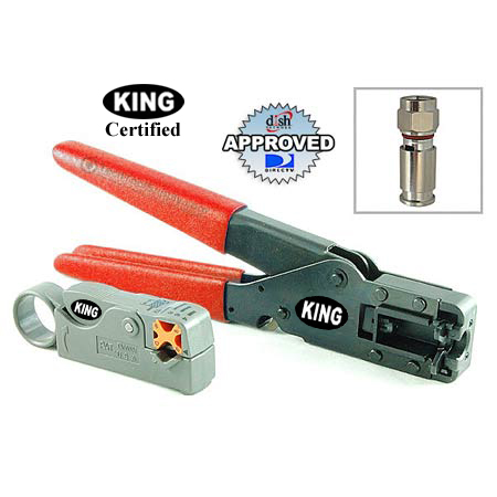

Snap and seal coax connectors are the way to go
Proper cramping is required

Can you build you own cables with snap and seal coax connectors - any idea how much the equipment costs?

- Compression connectors, snap and seal.
Great weather resistant. Less problems

If yo look under RG6 on e-bay
There are hundreds of listings
Check this one $40:
However
I'm not too crazy about brass connectors
Also check amazon.com
http://cgi.ebay.com/COMPRESSION-COAX-RG6-CONNECTOR-CRIMP-CRIMPER-F-BNC-RCA_W0QQi temZ160264470632QQihZ006QQcategoryZ4693QQcmdZViewItemQQ_trksidZp1742.m153.l1262
