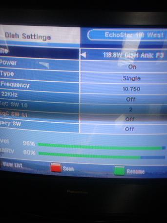

so basically u do have 118.8
go to menu dish setting and tell me what kind of setting u are seeing on ur 118.8 dish
Username: Jballer
Post Number: 12
Registered: May-09
LNB Power - On
LNB Type - Single
LNB Frequency - 10.750
LNB 22KHz - Off
DiSEqC SW 1.0 - 2
DiSEqC SW 1.1 - Off
Legacy SW - Off
Username: Saqeeb9000
Post Number: 4987
all ur settings are correct. i hope u get both level and quality signal ( both should be green ) and 118.8 dish name right on top..

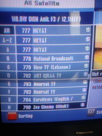

Username: Jballer
Post Number: 13
Registered: May-09
Both the quality levels are green and on top it syas echo 118 west and light is green on the hub and i have the latest file 1.85 and i am in network mode...the thing is that i cant go to the channels because they are not in the guide for 118 i only get a few channels liek 809 812, 793 and 790
So i think i am doing something wrong and am not scaning properly or something cuz i am unable to pick up the rest of the channels
Username: Jballer
Post Number: 14
Registered: May-09
the level is 95% and Quality hovers around 82%
Post Number: 4990
oh i got what u mean,
press ok button then with remote move the left button and take it to the top where it says all that will show u all the channels , u can also move it to a-z where it will show u all channels alphabatically
or a,b c i think thats what u have right now which will only show individual channels alphabtically

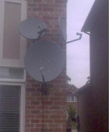

this is my dish setup

so do i need to get a new lnb for my 118 dish?

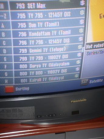

as stated before i am getting some channels but i am missing many like b4u and sahara sony
Post Number: 4994
so basically u are watching other channels and missing b4u , sahar and sony
so here is to get those channels
go to menu installation, mannual scan
sat name is 118.8
freq for sahara tv 12,033 ,go to freq and find this freq , if this freq is not listed u can do add tp by pressing green button and put freq 12,033 freq 20000 leave polarity and scan the channels from there
for sahara tv/b4u and sony
freq is 12033, horz, 20000
same for b4u and sony ( so just do only once ) and u will get all those channels

Username: Jballer
Post Number: 22
Registered: May-09
sada thanks tht worked i got most of them now, i m missing b4u music now can you tell me the freq for that 1 also please and thankz again
Post Number: 4999
12050,ver,20,000
u are welcome and enjoy
