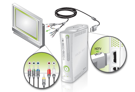

Cristoff Unregistered guest | I have just bought an XBox 360 but cannot get it connect to my HD Ready Philips TV using the HD Cables. Can someone let me know what I need to buy to cennect it to the TV. Thanks. |
New member Username: Phi76erso0o3East brunswick, New jersey United states Post Number: 1 Registered: May-06 | i have an hdtv ready t.v. and i have an xbox 360, am i able to buy something that i can get to play my games HD without geting a big expensive tuner because i dont realy want to watch hd tv, jus the games |
Silver Member Username: John_sColumbus, Ohio US Post Number: 914 Registered: Feb-04 | Use the cable that came with your 360: ![]() |
New member Username: Phi76erso0o3East brunswick, New jersey United states Post Number: 2 Registered: May-06 | no no, i know that, but i have a hd ready t.v., and in the front it only has 3 outlets, and the hd wires have six, is there something i can buy so that i can play hd. because i dont want a tuner. and in the front of my tv where it had the 3 outlets, next to it it has another different outlet so i can plug something else in. get it? |
Silver Member Username: John_sColumbus, Ohio US Post Number: 916 Registered: Feb-04 | "and the hd wires have six" No, HD wires, or at least the red-green-blue component wires pictured above are only three wires. All HD ready TVs have at least one set of these three-wire component inputs made to utilize the component signal coming out of your xbox and other HD devices. That is all that is required for an HD picture. They also show the red-white wires being used for the sound. If your TV does not have a component input, it is not an HD ready TV. Get it? |
New member Username: Phi76erso0o3East brunswick, New jersey United states Post Number: 3 Registered: May-06 | ooo, ye i see, i jus checked the back of my tv and there was green blue yellow red and white, so if i hook my 360 up to it it would look like im playing on a plasma t.v with the same quality? |
Silver Member Username: John_sColumbus, Ohio US Post Number: 917 Registered: Feb-04 | "ooo, ye i see, i jus checked the back of my tv and there was green blue yellow red and white, so if i hook my 360 up to it it would look like im playing on a plasma t.v with the same quality?" Since you have not specified your TV's model number, I can only promise HD quality if your TV has a component (RGB) input. But with a component input, it must be said that even that does not guarantee HD quality video. There are TVs with component inputs that are not "HD ready." |

New member Username: Johnny321Post Number: 1 Registered: Sep-07 | i have a samsung LCD TV LA32R81B that is hd ready. But i cannot play my xbox 360 games on high definition. please help!? |
Gold Member Username: John_sColumbus, Ohio US Post Number: 1820 Registered: Feb-04 | shiv, you must have a proper component hookup to the TV from the xbox. That hookup looks like this. ![]() |
New member Username: Johnny321Post Number: 2 Registered: Sep-07 | hey, i have already tried to connect the way you have shown above, which i got from from the xbox360 website. But even after this blue screen appears on tv. |
Gold Member Username: John_sColumbus, Ohio US Post Number: 1822 Registered: Feb-04 | First, I am assuming you have selected the appropriate component input on the TV. Second, you must select "HDTV" on the connector, as the diagram shows above. Third, you must select hi-def output in the "System Area" on the xbox dashboard. If it gives you a "720p" option, select that. |
New member Username: Johnny321Post Number: 3 Registered: Sep-07 | i have done all these things....but the hd option is not highlighted on the xbox dashboard because of which i cannot select it. Do i need some other external tuner for my HD ready TV? pls guide! |
Gold Member Username: John_sColumbus, Ohio US Post Number: 1825 Registered: Feb-04 | Are you trying to play an older (pre-360) game? Does you xbox have a hard drive? |
New member Username: Johnny321Post Number: 4 Registered: Sep-07 | No i am only playing xbox 360 games of pal version and my xbox 360 has a hard drive. all the games are new and are working on standard definition. the thing i want is to play them on High definition on my samsung LCD TV LA32R81B that is HD ready using a component hd cable but im unable to do so even after connecting. |
Silver Member Username: HuronPost Number: 200 Registered: Mar-07 | go to system, console settings, then display, hit on HDTV setting, then spank it into the setting you want, if everything is a go it will show as a current setting on display like, current setting 720p wide screen standard, for the cable xbox give you the crappest cable they could supply, theres a switch on it for high def that you might have to giggle back an forth real hard untill you break it into a permenant position, then go to bestbuy and for $50 you can buy the cable that should have come with it, and buy a optical to plug into that, dont buy the moster version or you will end up spending money on there stupid optical adapter unless they finally fixed that, if you have everything hooked up right you should notice a huge improvement on your display menu, it wont look grainy any more it will look very clear, if your getting a blue screen then the signal is not getting threw, or your not selecting the right one on your reciever or if you have it direct to your TV then on that, hay john whats with the green high light thingys, its getting real irritating everytime my curser tuches them, I didnt notice them before? |
Gold Member Username: John_sColumbus, Ohio US Post Number: 1827 Registered: Feb-04 | "hay john whats with the green high light thingys, its getting real irritating everytime my curser tuches them, I didnt notice them before?" This forum has gotten cute (like others) and has added auto pop-ups on key words. It's all about money. Angelo, it sounds like Shiv hasn't shown his xbox who's boss. You are saying things like "spank it" and "giggle back an forth real hard untill you break it into a permenant position." Seriously, it did occur to me that their stupid switch on that wire wasn't working right. Also, Shiv is either in India or England, so he doesn't know anything about Best Buy. He probably does know about Monster Cables. As everybody knows, Monster rules the world! That said, even if the xbox cable is crap, it should still at least give Shiv a picture, don't you think? "all the games are new and are working on standard definition. OK Shiv, what hookup are you using in this instance.? Oh yes Angelo--thanks for coming over to help here. But then you probably needed a break from Halo 3. ![]() |
Silver Member Username: HuronPost Number: 202 Registered: Mar-07 | I dont play Galo Galo is just that, Gayy, I play close to real combat games, Battlefield2 and the first Ghost Recon, that way when Im cleaning my 7.62x39 Russian VEPR Im not thinking of futuristic cartoon weapons that dont exist. why am I not getting Email from this site now, whats going on Jhon I leave for a short time and now everything is turning Communist, check out my new bender dall, Hes an alcaholic robot with suicidal tendencies and a bad aditude ![]() |
